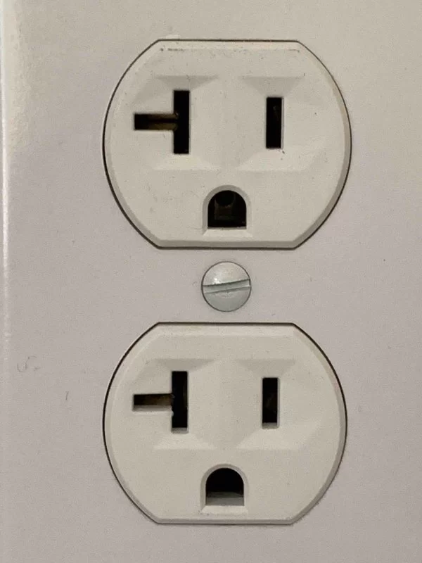

My house is 8 years old and the builder put a "240v vehicle charger" socket in the garage. But it looks exactly as the other socket. I.e. NEMA 5-15 plug.
Is there such a thing of NEMA 5-15 plug at 240V? If so, this may be a plus for me. I am very tempering to just plug in the level 1 charger into that outlet.

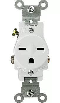

Is it possibly a NEMA 6-20 or 6-15 outlet? Both are 240V and look closer to the 120V 5-15:
It's also possible they ran a 240V 4-wire circuit wire, but connected a 5-15 outlet to just one leg for 120V now, and you could change to a 240V outlet in the future. Thomasz, if you post a picture of both the outlet and the circuit breaker involved, we can give more insight.
I was surprised to see how many different types of 240 v outlets there are, with different slot/hole arrangements, when I used Google images to find the photo I posted above. Certainly you can find outlet types which more closely resemble a 120 v outlet, but none of them are going to fit a 120v plug. At least, I hope not!

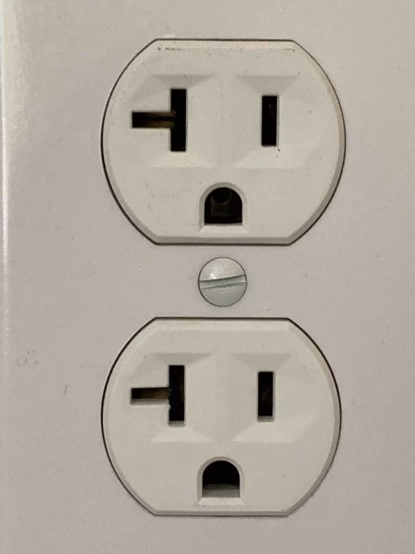

Please post a snap shot of both the receptacle in the wall (the wall socket) and the related circuit breaker(s) in your electrical panel. It will probably show in the picture, but also tell us the breaker rating in A on the tip of the breaker handle.
If it looks like a regular 120V outlet (i.e. like any regular 120V plug would fit), they were probably telling you (as mentioned earlier) that it is a "beefed up" or more robust 120V AC outlet for 20A. That would make the most sense, because many EV owners have had some problems with overheating plugs and/or wall sockets (for any number of reasons) with the regular L1 charge cord plugged into a 120V home / garage outlet.
120V outlets have a longer vertical slot (neutral, voltage close to ground) and a shorter vertical slot (hot, 120 V AC measured to neutral). One indication of a 20A 120V AC outlet would be a small horizontal slot perpendicular to and part of the slightly longer slot (looks like a horizontal "T"). If that is the case, you will probably find a single pole breaker (one handle), probably 20A in the circuit breaker box for this outlet.
If it is something more exotic, we should be able to a get a better sense of what you have from the pictures.

Yes, this is a 20A circuit at 120VAC (L1).
We use these at work to power our rack mount UPS in our MDF/IDF/LDF network installs.
The UPS does not have the standard home 15A plug...

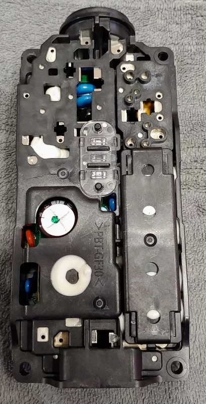

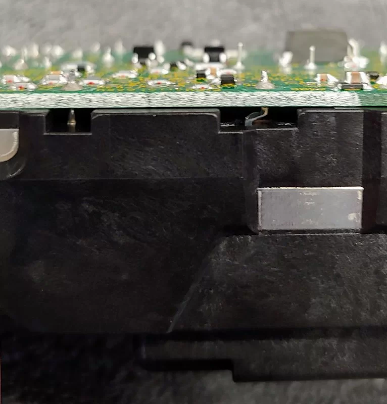

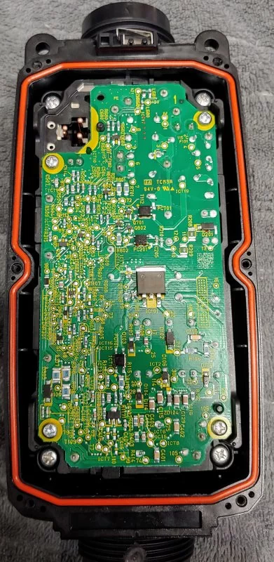

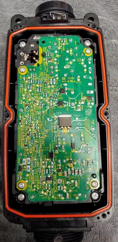

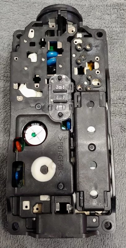

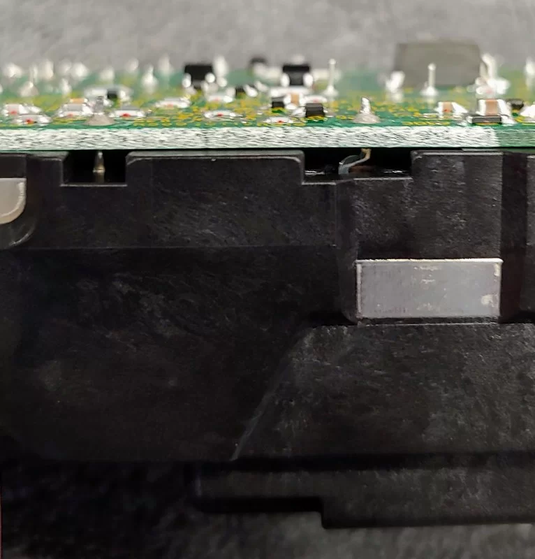

I have taken apart the included charger and unfortunately there is no way to check if the components are rated for more then 120v. the top side of the board where the regulators and capacitors are is covered and then soldered in place and glued. I do not want to go any further as I would most likely damage it diving any deeper. Maybe the pictures can be useful to someone. I would agree with other posters and say to just get a charger designed for 120v & 240v then risk damaging something.
View attachment 2921 View attachment 2922 View attachment 2923
Hi, on the picture of the open charger that you posted, there is opening in the plastic, for large aluminum capacitor with green dot on top, than red disc varistor beside. This varistor is to protect the circuit from over voltages, if input voltage too high it will limit it and will blow fuse and the varistor also, and the damage is minimum fuse and varistor. If varistor rating is 150v , the circuit will not work for 240v. If value is 250v or 275v the circuit is designed to work for 240v. The voltage rating will be printed on the side of this red disk varistor component, like 150 or 250 or 275. Can you check what is printed on this red part?
That mov has the writing of 160 76 on it but appears to be on the output side of main mos ic on the bottom ic101 which seems like a switch mode power supply for the charger itself. The main input capacitors are 440v rated. And the input mov are znr v10621u which are 470v rated

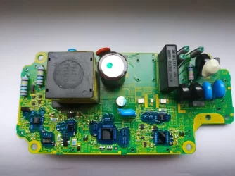

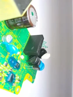

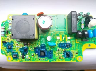

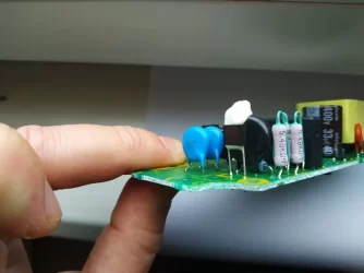

Hello from Ukraine! I'm just searching the information about using Level 1 120v charger at 220v. And to be sure that the charger can run from 220v, I decided to look at the internal components. here is a photo. As you can see the main capacitor is on 400V, the input varistors V10621U 2pcs and V14621U 1pc (by datasheet: 100 to 240 V, Line–Line and Line–Ground Applications), X2 capacitor is on 310V, input diode bridge UA80 on 800V. The main charger IC MIP2E1DMC, max voltage is 700V. Seems that charger is designed for wide range of voltage, I think it can run from 220v without any problems. Any ideas guys?

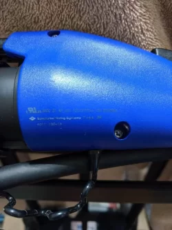

If you look on the side of the J1772 end of the Honda OEM evse, it reads "120/277 vac"...
I've used my Honda OEM evse countless times on 240v power. Takes about 5.5 hours to charge a fully 'empty' battery. Pulls ~11amps @ 240vac.
