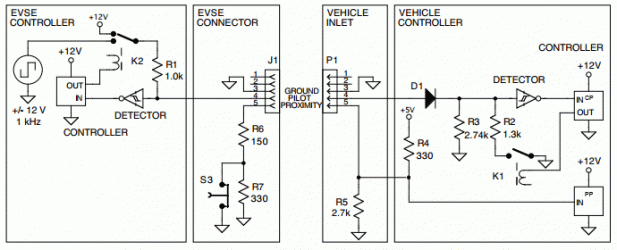

According to J1772 protocol the charge current is limited by PWM a 1khz pilot signal.
https://en.wikipedia.org/wiki/SAE_J1772
If duty cycle is 20% max current is 12A, I suppose Level 1 OEM charger use this duty cycle.
Duty cycle 10% corresponding 6A charge current.
My task is to limit current within 6А.
I have an idea to find a PWM generator on PCB, to made a duty cycle decreasing circuit (for example on NE555 timer), run it from original PWM. And output of decreased PWM connect to pilot signal.

Today I was try to emulate connection charger to EV. By the SAE J1772, when Pilot line is not connected, it must be +12v, in my case it is about 20mV. When connecting resistance to CP-PE nothing changes, pwr led is ON, and after about 1minute, Error led begin blinking (6 times, than pause). Any ideas?
Today I was try to emulate connection charger to EV. By the SAE J1772, when Pilot line is not connected, it must be +12v, in my case it is about 20mV. When connecting resistance to CP-PE nothing changes, pwr led is ON, and after about 1minute, Error led begin blinking. Any ideas?

I connect 2740Ω and through the switch 1300Ω betwen ground and pilot line. And there is no voltage on pilot. Ground is connected to charger. And proximity pin is not connected to charger, it connects to ground with resistance and latch.
I am confused if you are talking about connections on the charger, or on the car.
If there is no power on the charger pilot line, that is a fatal error that must be addressed.
If you are connecting resistors to the car, you need to supply a 12V power supply. I believe the car provides the resistors, to determine charging request.
I connect charger to power supply 220v, and no car on output. Instead a car - resistance 2740Ω betwen ground and pilot line, as described on J1772_signaling_circuit. And there is no voltage on the pilot ground. When error blinks, there are -12V on pilot line (fault). Error start to blink at about 1 min after connection to power supply.
The charger should be expecting the resistance to drop, with the 1300 ohm resistor added in parallel. It may fault out if that resistor is not added.
Sequence indicates PWM starts with 2740 resistor, but charging starts after 1300 resistor is added.
I add 1300 resistor in paralell, but it is not change anything. No PWM, no DC voltage, no matter which resistance is connected, only -12V appears when the error flashes.

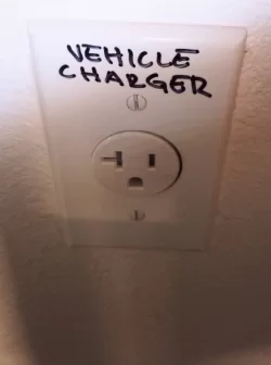

A somewhat puzzling statement as it is highly unlikely. Who told you this, the builder, previous owner, salesperson? Have you used the outlet previously for anything?
My guess is you were misinformed. Unless maybe they wired the circuit so that the outlet could later be converted to 240V. Or maybe it's a 20 amp 120V circuit and whoever passed this information on to you just got confused?
Maybe post a photo of the outlet and people here can help you identify it.
I'm very sorry for this super late post. somehow I did not see this. I attached the photo here. My builder's agent did tell me it's 240v -- otherwise what's the point of the label vehicle charger?
It would be bad news if that was a 240-Volt outlet. An outlet like that is supposed to deliver 120 Volts at up to 20 Amps, so if you find a rare 120-Volt EVSE charging cable that uses more than 12 Amps, this outlet is ready to provide all the power it can take.
The label probably indicates the outlet is not shared with other outlets in the house, so you won't blow the circuit breaker when you have your toaster, electric blanket, and electric space heater going at the same time as when you're charging your Clarity.
Weird. I don’t think an outlet like that is supposed to provide 240v - too easy to plug in a 120v item. It could work, but not likely to code.
Anyway quite easy to check with a voltmeter. You’re looking for about 240v between the two blades and about 120v between each blade and ground.
I agree with the others that this is highly unlikely to be 240V.
You can measure it to be sure.
It would also be good to have a look in the circuit breaker box.
If you can identify which breaker this is, then you would know the amperage and you could tell visually if it is 120 or 240V.
Keep in mind that if it is 120V AND it is a dedicated outlet (only outlet on that circuit breaker), you can quite easily change it to 240V for a very low cost. The breaker would be changed, and the receptacle would be changed (no need to change the wiring which is the most expensive part of an electrical job).
If you change this over to 240V and keep the same wiring, it will be Level 2, but it probably won't be able to charge at the full rate that the Clarity is capable of (30A). It will still be a dramatic improvement over Level 1, but you will have to determine the current capacity of the wiring and use an EVSE that limits the current to 80% of what the wiring is rated for. If you find out the current rating of the wiring, I can tell you approximately how long it will take for a full charge.
Is it kosher to keep mis-colored wires? Here, you’d end up with a white wire that’s supposed to be neutral instead carrying 120v. Of course, that would work, but somewhere down the line someone could get quite a shock making assumptions about a white wire. That said, I’ve been known to paint the exposed wire jacket - in my case painted green for a white wire that was serving as ground. Less dangerous than a hot wire with a white insulation.
