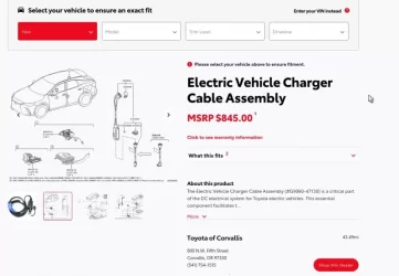

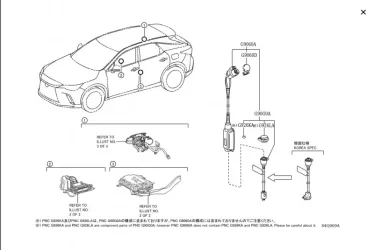

We just got a 2022 Rav4 prime. The best/closest out let for the car in the garage is next to the freezer and, as I knew it would, the car popped the circuit breaker when the freezer cycled. I had a 220v outlet installed in the garage for a welder. I have just come back from a trip in Europe and used my computer and USB chargers with a simple straight through adapter. I wondered if the charger may be universal power type since it made sense for world wide marketing. I Googled the part number on the charger, G9060-47130 and found these images. I saw these images on other Toyota sites also. Observe this image carefully. As you can see the wall plug assembly can be replaced. Notice you can buy the "pig tail" for Korea. What kind of power does Korea use? 220v 60HZ !!! The exact same power the US uses. QED It seems the US and Korea are some of the few countries that use the same common power type unlike European 230v 50HZ.

Isn't the US standard 240 Volts AC, not 220 Volts?
This thread discusses how Honda' OEM Level 1 EVSE for the Clarity works on 240 Volts. It wouldn't be surprising to learn that every OEM EVSE is designed to handle 240 Volts, for many reasons.
