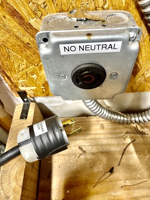

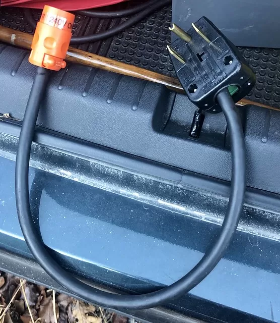

I’ve shown this before, but here’s my home made adapter cable:
Each blade carries 120v, the pin is ground and I left off the neutral blade to avoid confusion. It’s handy when charging midday for a couple hours to pick up 20 miles of EV range as opposed to 8 miles.

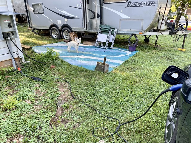

And here it is in use the other day with a 50A RV pedestal:

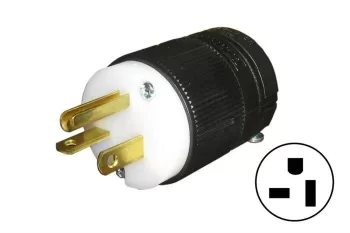

The Home Depot Adapter has an NEMA 6-15 / 6-20 receptacle that looks like this:
You cannot plug a standard 120V plug into this receptacle (for good reason, because this receptacle is 240V). I realize that is the intention here, but in general, it is not safe so the keying does not permit it...
Here is the plug on the Honda OEM EVSE. It is a regular 120V plug (NEMA 5-15p):
Note that the horizontal receptacle contact blocks the vertical blade of the plug.
You may be fooled by the appearance that a "20 amp" 120V plug could fit into the NEMA 6-20R...
Here is a 20A 120V plug (this is a NEMA 5-20p, but I have never seen one in real life):
At first glance, this "appears" to have the same configuration, but it does NOT. Again the horizontal receptacle contact will block the vertical blade on the plug.
The NEMA standards are totally oriented around safey, and it is virtially never safe to plug a 120V device into a 240V receptacle so the contact configurations do not permit it.
The EV community has found a rare exception, but you need to build (or buy) a specialized adapter to do it !

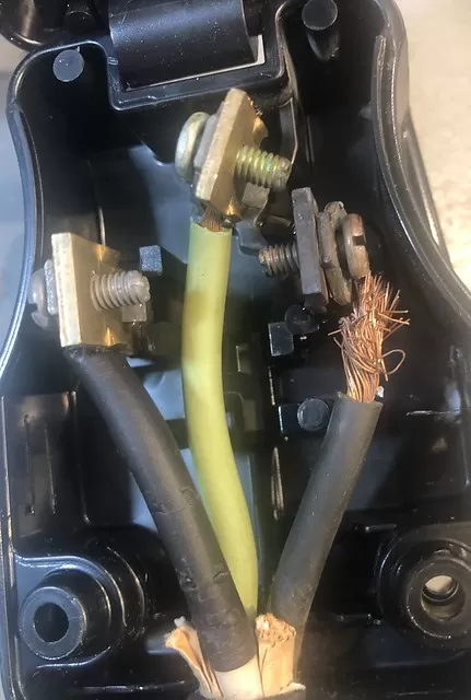

As an aside, I made up two - the one discussed for the 50A RV receptacle and another for an existing 30A RV receptacle I have in the hangar of my TN home.
Both have worked flawlessly…with one exception. As I’ve mentioned before one of the screw connections on the 50A plug came loose, causing overheating and some melting of the receptacle. Just be sure your connections are rock solid and be sure to check them once in a while.
