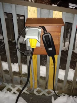

I made an "adapter" to connect the oem charger to my 14-50 outlet for my normal evse and ran it for 30 minutes on a pre-conditioning cycle. All ran fine, nothing got hot. The app did indicate that it was charging at 240v a clamp meter showed the charger was limiting to 12a current. All of this is use at your own risk and I do not advise it, but wanted to know once and for all if it does work.

Yes, the pilot signal would not change as the evse is still limited to that current. There is no safe way to convert the oem charger to 240v without changing the plug which would be difficult with the temp sensor, that is why I am not recommending it. I will try a full charge tomorrow and keep an eye on things.
Completed a full charge with the OEM EVSE at 240v without any issues. Charge time was noticeably slower then my 32a EVSE, around 4.5 hrs from 2 bars of battery. That is still way faster then 120v. The OEM EVSE only reached about 10f above ambient, and nothing else went much above ambient, it stayed cooler then my 32a EVSE. Again use at your own risk even though you know your adapter is 240v someone else may not.
