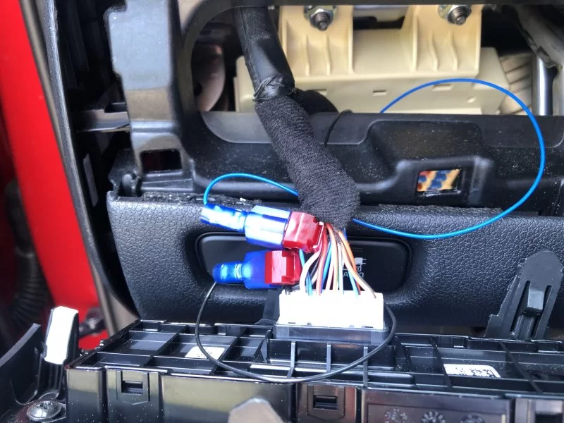

OK...so let me make sure I have the wiring right then....Kia wiring harness on the left, switch wiring on the right below
KIA PINK to RED switch wire
KIA BLACK to BLACK switch wire
KIA blue/black to BLUE switch wire
Now where does the GREEN switch wire go to on the KIA harness?
And the YELLOW switch wire goes to nothing.
Much appreciated!! This is going to be huge.
The green[common] is also ground so it get connected also to Kia black, or just jumped on the switch

In terms of process, is this the correct order:
  1. Snap on disconnects to Blue, Black and Blue wires
  2. Connect terminals to disconnects
  3. Insert switch wires to corresponding terminals
  4. For the green ground wire what do I need to close it or do I connect to Black terminal too?
Am I missing anything? Thanks again for all the help!
Turns out I actually got the 12mm one
Sent from my Pixel 3a XL using Tapatalk
Thanks as I wasn't even thinking about the size.
Is this the correct order and all I need to do?
  1. Snap on disconnects to Blue, Black and Pink wires
When the car is off there is no power to any of the wires, so the order of connection is not very important. Your process should be fine
Now you need to add a momentary switch across these two points. Those red plugs will accept a 1/4 MALE quick disconnect, not the more common female
https://www.mcmaster.com/7243K118/
You can wire it differently, this is how I chose to do it. View attachment 12207

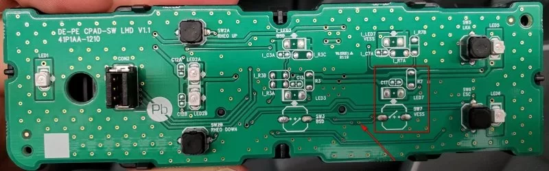

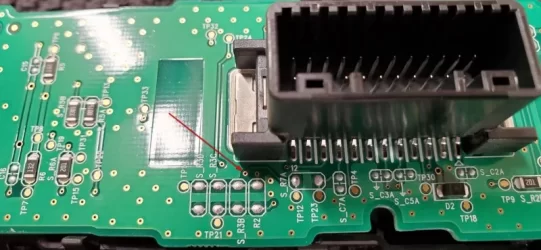

Hey Guys, just got my brand new Niro EV "MY 22 Germany" 2 days ago and can't stand the VESS. On the model I tried at the dealer prior ordering one there was a switch to shut off VESS. Now aperently all MY22 don't have it anymore.
So I just ripped the switchboard apart and took some photos.
Is this the right PIN?
Mine is Blue-White.

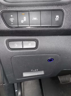

Just wanted to say thanks for this. That noise has been driving me nuts. Some extra thoughts since I just completed this:
  • I loosened both screws (there are 2) on the lower panel. Then pull the top of the lower panel out just a little bit. That will release the switch trim panel that contains the switches. Also lower the steering wheel as far as possible - it makes it easier to reach behind the switch trim panel to pull it out.
  • Disconnect the wire harness from the lower trim panel (with the charge button) - that will make it easier to get more of the wire out to work on it.
  • I used 3M scotchlok for tapping. They're a bit harder to use since both wires have to be in place when you compress them. But I don't trust the random no-name brands of the other type.
  • I used an old 3 pin fan cable extension from a computer I had laying around to make a connector. Cut it in half and wired one end to the switch and one end to the taps. That way if someone needs to pull the trim panel, they can disconnect it easily.
  • Locating the hole would be simpler if you also pull the lower trim panel - I'd have preferred it to be centered on the switch cluster but with the airbag in that panel I didn't want to mess with it and there are plastic mounts behind the panel so you have to be careful where you drill.
  • I only had a 1/2" bit (would have preferred a 15/32) and it stressed the plastic on the edge of the hole a little bit and turned it white. Used a black sharpie to color those in before mounting the switch and no one will ever notice.

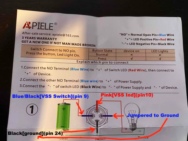

I bought the same switch (and one of the larger ones mentioned in a later post) and now am trying to merge @pepsi216 and @ENirogus comments on how to wire this up. I think understand what ENirogus is stating but that differs a little from the above (as I think one of the NO terminals is also connected to Ground).
I believe the attached image and the below is the correct way. This appears to make sense (to someone who took EE 30 years ago). When the button is pressed, the normally open (NO) circuit is closed and momentary provides a path from ground to the VSS Switch (just like the KIA schematic).
I believe the attached image and the below is the correct way. This appears to make sense (to someone who took EE 30 years ago). When the button is pressed, the normally open (NO) circuit is closed and momentary provides a path from ground to the VSS Switch (just like the KIA schematic). View attachment 13904
Kia Switch
Blue/Black[VSS Switch](pin 9) ->Blue(1 of 2)[Normal Open(NO) Pin]
Black[ground](pin 24)----------->Blue(2 of 2)[Normal Open(NO) Pin] and Black[Negative of LED Switch]
Pink[VESS Indicator](pine10)--->Red[Positive of LED Switch]
Any comments before I do this in the coming days?
Thanks
Ok. Did this. Not exactly the results I was expecting meaning:
1) Expected: pressing button disables VESS
2) Expected: pressing button again re-enables VESS
3) Not expected: Switch LED does not stay on when VESS is disabled
4) Not expected: Switch LED only lights for the time the button is actually pressed in
With that behavior, I relooked at the Apiele data sheet. I assumed that configuration 1's (the photo that I had above) statement of "Press the button, led light on" meant stayed on, but no that just means it momentarily lights when pressed in like I observed.
I need to look at the post about how the bigger Apiele switch was done as that behaviour is what I wanted. I have one of those switches also, so I might do a swap. Will see.
Job done. Moved over to the bigger switch which as wired will be lite up when VESS is enabled. I decided to drill into the fuse box cover due to 1) if I screwed up the drilling, easier to replace and 2) in case of warranty/dealer maintenance, I might want to hide the switch. Another advantage to that larger switch is that it has a disconnect at the back.
So, it sounds like the NO pins shorted momentarily as they enabled/disabled VESS correctly.
But there must have been a connection inside the switch that controlled the LED, as it wasn't controlled by the +12V on the pink wire? Maybe it wouldn't have lit if the +12V on the pink wire wasn't there? If so, that is unexpected, given what was shown on the data sheet. Glad you had the other switch!
BTW, I put my button in exact same place as you did, on the fuse door, for the same reasons. Don't think I have seen that done before, but I thought it made sense as well.
