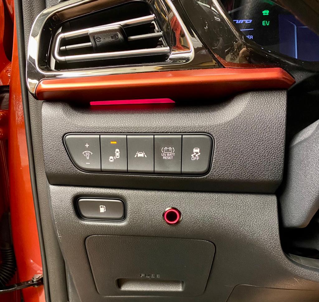

Here is the finished product. There are some plastic support ridges in the panel so it only has a few places it could go. I think it came out pretty sharp. Works great and super easy fix! Thanks again.
While this solution is the most elegant thus far, I think putting a switch in place of the fuse is the easiest. (Discussed in other threads) It's $50, but ultimately worth it. No disrespect to the ENirogus who figured all this out.
Well, the fuse shuts off more than the sound, so there is that disadvantage.
Cory thanks for posting the pic, very clean install, you would laugh at me, my switch is just hanging around the steering column

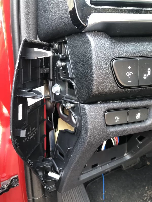

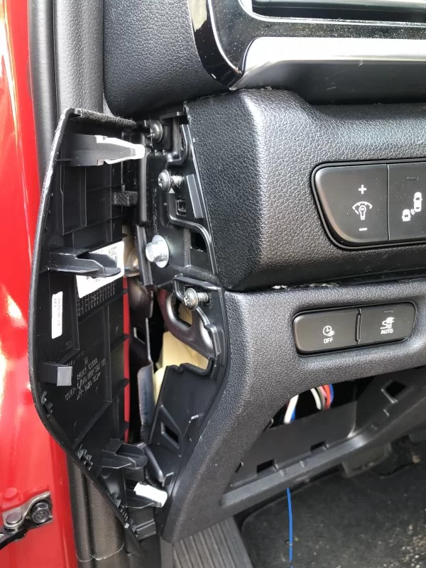

First you need to pull the crash pad switch panel out.
To do this you need to start with the door aperture trim panel, which will pop out with a trim tool or carefully with a screwdriver. It is retained by the door seal, but you can leave it tucked in View attachment 12205
The two screws seen here backed out need to be removed. The lower panel that contains the fuse box door can be pulled out and down without totally removing it. Then the switch panel can be pulled out, you can get some purchase with your fingers between the steering column area. If you haven't removed newer car trim, it takes a good pull but do be a bit careful
