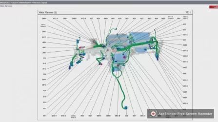

Economies of scale being what they are, Kia did not make a different wiring harness for the US cars, so it turns out the wires extend all the way to the 'crash pad' switch assembly, although there is no switch. By examining the factory wiring diagrams, there is a blue with a black stripe wire that runs to the connector that when momentarily grounded, disables the VESS system, until you push it again or turn the vehicle off and on again.
I will put the wiring diagrams at the end as they are only for understanding what is happening.

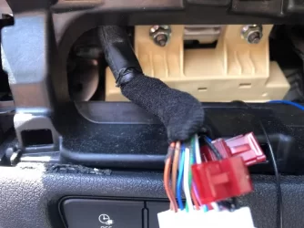

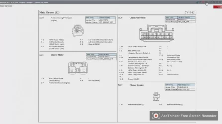

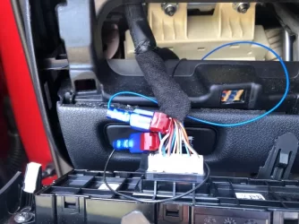

Once the switch panel is out you can see the connector on the back of the switch assembly. This is connector M26 on the wiring diagrams. There is a blue wire with a black stripe that needs to be tied into. I used these:
https://www.mcmaster.com/69515K23/
The snap onto the wire and allow a 1/4 male quick disconnect to plug onto it
The Blue/black wire is on pin 9 of the connector. Ground is a black wire on pin 24
You can use whatever switch you choose, and mount it wherever you want. IT must be momentary. Press once with the car on and the VESS [fwd and reverse] is off, press again and it is back on again.
A latching switch[that works like your basic light switch] will not work, the system will revert to 'on'

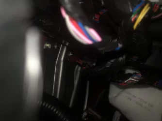

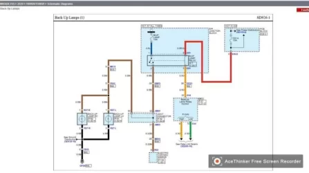

I have ideas to have it just shut off the reverse chime, and to do that access to the reverse circuit is required.
There is a connector nearby 'JM03" forward and above the fusebox
In the center of this image is a connector with 3 brown wires[pins 30,31,32] and a bunch of gray wires, the 3 brown wires are all reverse light wires. You can see I have attached one of the red taps to the brown wire.
I have not figured out a way to automate the reverse defeat, but I am thinking about it.

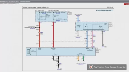

So I don't see wiring pinout for that switch, but the idea is you would have ground wired such that the LED is always grounded and the black/blue wire momentarily gets ground when you push the switch, and the pink wire goes to the positive of the LED. The part of the schematic I posted that shows 'VESS UNIT' and CARSH PAD SWITCH shows the same pinout you would use on your switch
OK towards the end of the video. there should be a '+' and '-' on the switch. Ground goes to the minus. Pink [from car] goes to '+' as I think this is the positive of the LED. One of the terminals marked 'NO' should get the blue/black wire and the other gets ground[so a jumper between '-' and one NC contact, the one that does not have the blue/ black on it
