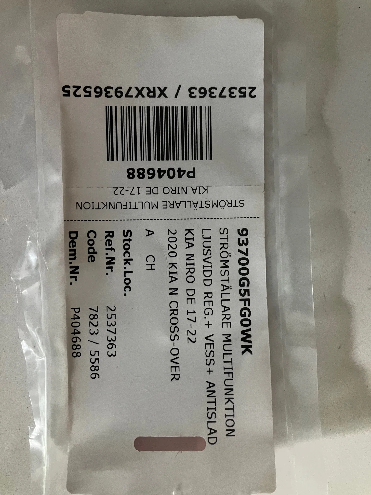

Bought my 2022 Niro EV used last fall and immediately had issues with the VESS noise. Did not want to do all the rewiring I saw on the forum. Found the VESS defeat switch in Sweden (autopart-24.com). Just installed it to replace the current switch. Took 20 minutes and works like a charm. See photo of part number. With tariff, it cost about $120 and shipment from Sweden took about one week. I would recommend this over the rewiring idea.
