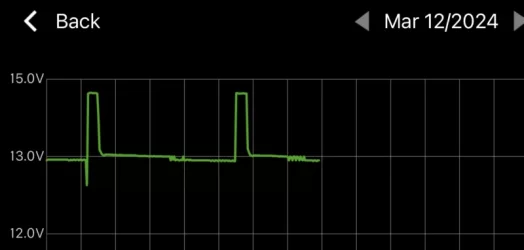

I am monitoring the 5 year old OEM Rocket battery with MB2 now. It seems to be topped off on a regular 4 hour schedule. Immediately after the 20 min charging session there is always a small dip in the voltage, then it settles at 12.85. By the end of the 4 hour period it drops to 12.78 -12.80, and it repeats. so it looks healthy to me. Trying to decide if I should swap it with and Ac delco AGM. I am unsure why the 12v batty recovered in this way, before it would be at 4-5v with the car dead.
I took a look at Kiwi-s posted charge graphs, and I notice one difference. My charge cycles always features a few minute of dip in the 12v battery voltage, then it comes back up to what I would expect after just having completed a charging. Kiwi-s graps does not have this dip. I wonder it the presence of this indicates a problem with my battery?
I am monitoring the 5 year old OEM Rocket battery with MB2 now. It seems to be topped off on a regular 4 hour schedule. Immediately after the short charging session there is always a small dip in the voltage, then it settles at 12.85. By the end of the 4 hour period it drops to 12.78 -12.80, and it repeats. so it looks healthy to me. Trying to decide if I should swap it with and Ac delco AGM. I am unsure why the 12v batty recovered in this way, before it would be at 4-5v with the car dead. Do you guys have an idea what may have happened to the Rocket?

...Immediately after the 20 min charging session there is always a small dip in the voltage, then it settles at 12.85. By the end of the 4 hour period it drops to 12.78 -12.80, and it repeats. so it looks healthy to me. Trying to decide if I should swap it with and Ac delco AGM.
Those voltages at face value look fine. However the dips are another question.
When the car is awakened for a 12V charge the 12V battery must support the LDC unit (converts HV to ~12V) for one or two seconds before and after the LDC starts supporting the 12V system. The magnitude of the dip at the end of the event would certainly reflect the resiliency of the 12V battery to handle the transition. I've seen in some cases where the settled voltage is lower after a 12V battery charge and wonder what the point of it was.
As an aside, note that the BM2 logging function only samples every 2 minutes so it may or may not always catch the resulting dips in the system voltage. If you monitor it live I believe it samples every 1 second.
... I wonder it the presence of this indicates a problem with my battery?

My Kona Rocket is at 5 years in a couple of weeks, and exhibits the same numbers: between 4hr charges is at about 12.8v+, at the end of a charge briefly drops to 12.65v then resumes, a short outing causes dips to 12.25-12.3v at each ignition off, followed usually by a 4x30min charge cycle but sometimes followed by 2hr at 12.6v instead, then back to 12.8+ 4hourly. The only difference is that I have not had a Rocket failure.
I’m not convinced I need to do anything immediate, primarily because when I look back to my earliest data (June ‘22), all the numbers and pattern were just the same then. But I haven’t bought a replacement as you have already - you might as well install it, check all is OK, then forget about the problem..

Kiwi, if I am reading your post correctly, the initial load of running the LDC unit causes my brief dip in voltage, This by itself indicates that my OEM battery is weak. The dip is maybe 0.4 volts and quickly recovers once charging starts.So the initial running of the LDC acts like a brief load test….
But on your charts, we do not see thiis dip.

Saw my first 'dip' today at the start of charging, so I'm not immune!
