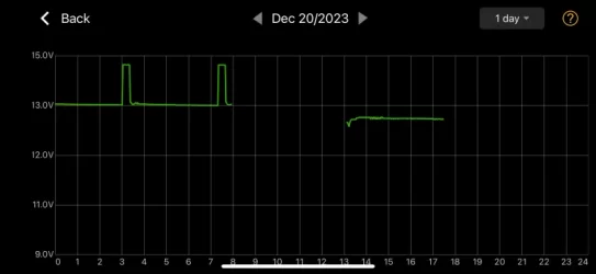

The situations to watch on the BM2 are (1) that charging is at 4 hour intervals, not more frequently, and (2) for 30 min at the start of AC (traction) battery charging, not longer. I bought a (very) cheap flooded DIN44 and my Kona hates it so I'm back with the old Rocket.

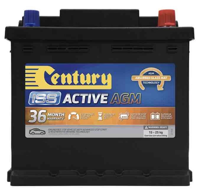

Meanwhile I just checked with Toyota and they have a Yuasa LN1 at $800. So I walked across the street to Repco and ordered the equivalent Century AGM which they said will be available this afternoon at $450.

My Kona protested about the new very-inexpensive 45Ah 'Endurant' flooded battery I installed in October by charging it over and over even though it was already fully charged. That won't hurt the battery but it's not great for the car. Without a BM2 I'd never have known this. That battery is now installed as a backup for my internet hardware in case of a power failure.

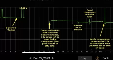

Now I've installed the new and very-heavy $450 Century stop-start AGM (at 1300 hours today after charging it off-line for an hour) and so far the car has simply ignored it! It should have "probed" it with couple of 20-min pulses as it has done every time I previously temporarily disconnected 12V power. I'm nervously awaiting some sign of recognition otherwise I may have bought myself a second expensive desk ornament.
It's very hard to find reliable and high-quality information about battery suitability. I recall a few Kona owners over the years have reported installing AGMs and so-far no one has reported a problem, but I'm not sure if they are checking the details as closely as I am. And, it's also possible some don't want to come back and admit their mistakes. I've asked a Hyundai tech, the dealer, and searched the service docs and all over the internet with no better information. But, the Kona's charging voltage seems suitable for an AGM and Yuasa recommend that type, so why not?
Of course I'd prefer to spend only $190 on a flooded battery but it's fairly clear to me that the capacity of that part has insufficient headroom to run the car without traction battery support past just jumping in, hitting start and driving off. The AGM offers not only more resiliency but better use of the 20 minute charging period due to the lower internal resistance.

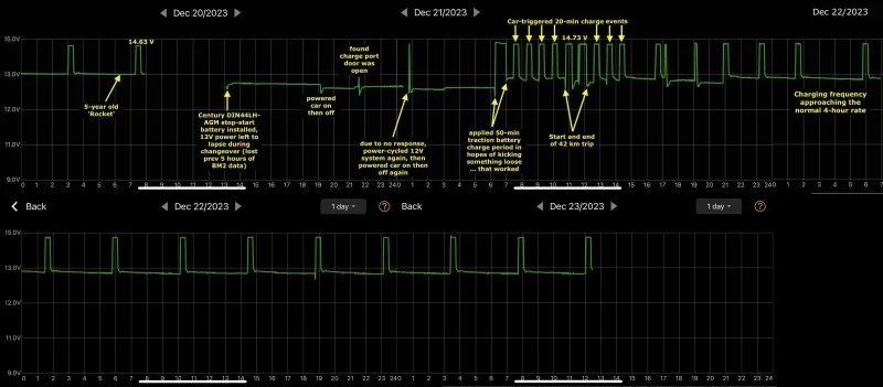

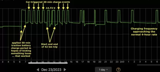

The new AGM 12V battery was ignored by the Kona until I placed the traction battery on charge for an hour. Then, after a series of frantic repeated charge events the car settled down into the normal routine. The Kona is charging the AGM at a slightly-higher (0.1V) voltage than the Rocket but settles to a lower level by a similar amount. Ambient temperature is in the 20-30°C range.
Actual image
Actual image

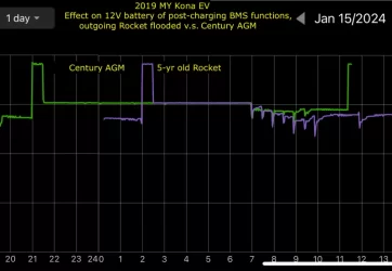

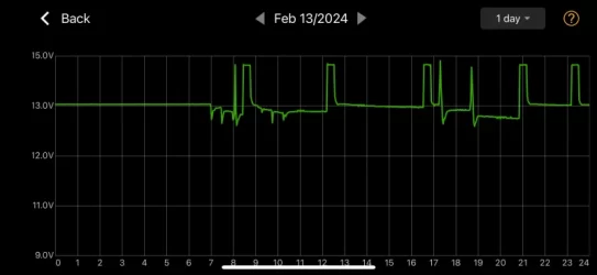

I had never used a battery charger on the OEM Rocket that is still good in its sixth year. I have used Utility Mode (14.5 V) a few times when I thought it needed help. The Rocket is sitting next to me here in the kitchen begging not to be dropped off at the recycler. I built a battery backup for my internet connection hardware and can use it for that.
The graph shows the typical behaviour after short drives. There's alway a net loss of charge on shutdown that isn't made up until the next 4-hourly scheduled charge event. At 2300 it added a second charge to make up for the low voltage found at 2100 (just before the previous charge) despite that just one charge was sufficient to recover.

When you swap it out don't attempt to support the 12V system, it needs to know that the battery may have been changed. This is the process I used and it did actually come from Hyundai: After the swap, enter Run mode (foot on brake) leave it for a half minute then switch it off. With all windows (and charge door) closed and the doors locked leave the car undisturbed for 4 hours.
If you have a BM2 you can check the progress. The last time I followed this process nothing happened in those 4 hours so I put it on traction-battery charge for a couple of hours, removed the plug and that kicked it into life. Mine took a few days to settle into the normal routine.

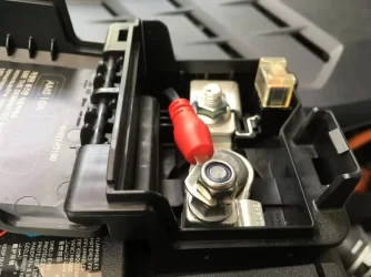

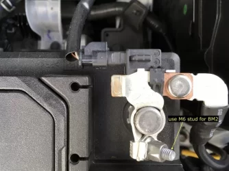

That BM2 is fine. In many cases you can install it without disturbing the battery power connections if you obtain (2) M6 nuts and use the free end of the existing studs. You can also place the negative lug under any other nearby grounded fastener.
