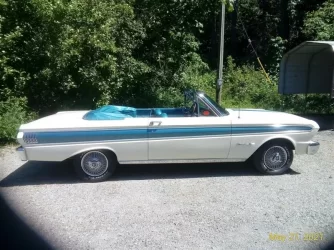

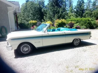

So I'm not entirely convince that my first 12v battery is no good. I think the problem is it doesn't get charged enough. I'm going to try this. I put it in my classic 64 falcon . It will get a constant charge and then I will see what happens. I will take my battery booster I got just in case it dies. I used the car today and it worked just fine I will keep everyone posted on the results...P_20210521_134912_p (Medium).webp P_20210521_134837_p (Medium).webp
Perhaps measure it since cars of that vintage would normally charge continuously at 13.8 V while running to suit non-calcium type batteries. The Kona charges at 14.7 V but not continuously, and as best as I'm aware that's what other modern cars do.
Thanks for that info... while running it's charging at around 14 volts I used the car all day and it starts etc. and hasn't dropped below 12.5 volts . All so the Hyundai has a lower cranking rating. So will I do damage to the battery by continuing charging it in the Falcon.
This I feel is the problem to begin with not enough charging to keep the plates clean just a enough to keep it a 12 volts. That lack of charging gives it a short life.
