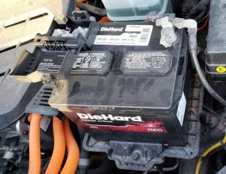

Have had my 2019 Kona for 3 years and the 12v battery has started dying regularly. First time was a few months ago so I bought a Li-ion jump starter and actually got a couple more months with no issues. Not so of late so after after searching various forums and some measuring I bought a Group 26R Die Hard battery from Advance Auto ($110). It's a perfect identical fit. No mods required.

For a month or so our 2019 has needed a boost pack to wake up. I've been to a couple local parts stores, where I was told "we can't even get the kind of battery your car takes" and yesterday, at the dealer they said "we can have one in 4-6 weeks". (I had to boost it in the dealership parking lot.)
I measured the battery and looked at a group-size chart (in addition to seeing this thread) and the OEM battery has the same dimensions as a 26R. I installed the same one as the OP - DieHard Red, 26R. Easy swap. I also fitted the plastic cover over the negative post (with a small bit of utility knife work). $110. Wish I'd done it a month ago!

I have the negative cover off Can you explain how you got that cover on maybe a pic ?
My wife takes this one to work everyday, so I'd need to remember take a picture over the weekend. Briefly, here's a description - The neg terminal cover has a long tab, that extended down the right side of the battery. That tab can be inserted into the handle slot on the side of the DieHard battery (loopy handle removed). The tab has a right-angle support on the back of it, and I trimmed that back about 1/2" so that the tab could reach far enough into the battery's handle slot so that it would clip into place. To make the terminal cover sit right on top of the battery, I cut the round appendages that used to stick into the top of the old battery back to about half their previous length.

From what I can tell the battery group size for the Kona EV is 99R (also known as T4). It's good to hear that a 26R will also work. Checking prices online the 26R is less expensive than the 99R.
26R slightly higher dimensions than 99R ~ 1", and 1/2 " longer. The cables attaching obviously have enough slack.

99R:
Maximum Overall Dimensions (L x W x H): 8-1/4" L x 6-7/8" W x 6-7/8" H (210 x 175 x 175 mm)
26R:
Maximum Overall Dimensions (L x W x H): 8-3/4" x 6-3/4" x 8" (222 x 171 x 203 mm)
