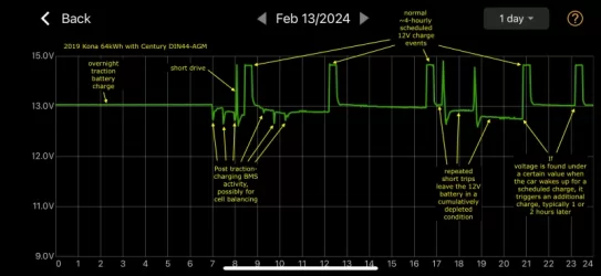

...the Yuasa LN1-MF which is a DIN44 AGM also but designed for EVs and hybrids.
Its still in the car and working ok. Touch wood.try charging your old battery it may be good for more years

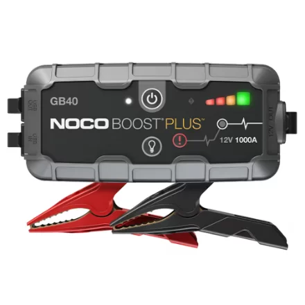

I use this one, also 1000 amp-works fineI’d like to get a portable jump starter - there are lots for 12 volt batteries - but their amps vary - does anyone know if a 1000amp one is safe to use on my Kona? (We recently had to replace our 12 volt - no big deal, but it seems like a good thing to have if the 12 volt goes sideways and the car will not start)
