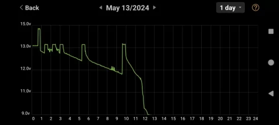

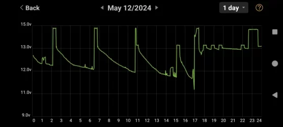

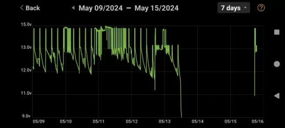

So I've now been bit by the 12 volt battery failure. Fortunately I'd planned for this and had the jumpstart pack accessible and all set to go, simply plugged it in since I'd installed the mating NOCO plug on the battery. Started the car, fired up the BMS app and took a look around. I confirmed that the rear door was securely closed, the car had been sitting locked up in the garage for three days.
The reason I quoted the part about cell balancing, is that this failure occurred after I did something unusual: charged the traction battery to 100% twice, and both times postponed the trip that I had been planning where I'd need that extra range.
It's very noticable, that since the middle of last week battery drain between 12 volt battery charging periods was much higher than normal, finally causing the battery to be drained to 9 volts two days ago.
I left the car in utility mode for half an hour, and after that the battery was charged to the point where its voltage stayed above twelve volts. After shutting the car off for a while, the orange light on the hood lit up and the car began charging the battery while being turned off.
The charging has since stopped with the battery voltage back up to 12.9 volts.
The question is, does charging to 100% sometimes kick the BMS into some state where it's desperately trying to rebalance the battery and thus quickly draining the 12 volt battery? At the moment all the cells are reading 4.14 volts.
I'm about to take it out for a drive and knock the SOC down below nearly 100% in hopes that this will prevent the battery from being discharged like this again.
Here are the traction battery charge and discharge events that can be matched up with the BMS graphs:
May 7, 07:00: finished charging to 100%
May 10-11: 200+ mile trip beginning at around 21:00 and ending around 05:00
May 12: 6 mile trip starting at 5 pm
May 12: 22:30: start charging to 100%
May 13, 01:30: finish charging to 100%
May 13, 12:00: battery falls to 9 volts
May 16, 17:29: jumpstarted

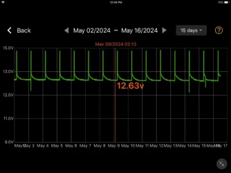

@mtd, I don’t see anything in your graphs to identify a current cause of failure, rather I see a battery that was already in terminal decline prior to this event. In good condition, a 12v will quickly recover from a current drain to a stable level - your graphs show consistent declines in voltage between top-ups.

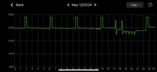

Below is a graph of my 5 yr old Kona 12v over 15 days - it has not had any significant discharge events. Voltage between 24 hr charging top-ups is steady at 12.63v as shown.
I should have mentioned, this is a 2023 Kona that is only a year and four months old, so I doubt that the battery has signficantly failed this quickly.
The one possible load is an OBDII dongle that I've left plugged in without any noticeable battery drain for a few months now, though this is likely one of the few times I've let the car sit for a few days without having an opportunity to charge while driving. I'll now leave it unplugged and see if that corrects the problem.

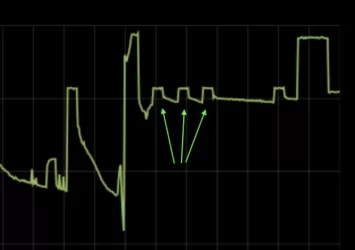

As a note, the three smaller 'steps' seen in 2 of your graphs are (IMO) the car 'reacquainting itself' with your 12V battery. In normal conditions that only happens when the 12V battery is disconnected, but in this case perhaps it's due to voltage drop below the minimum operating level. I suspect the car is establishing either or both the internal resistance or discharge resilience of the battery.
Just to the left and higher, the trimmed-off rising edge is certainly the LDC current-limiting due to encountering a severely-discharged battery. It's probably seeing in the order of perhaps over 100A for numerous minutes. I saw this once on my own car just after the dealer completed a BMS update.

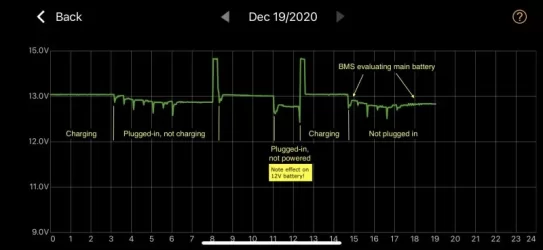

Another possible but probably unlikely cause could be leaving an un-powered EVSE plugged into the car.
Or this:

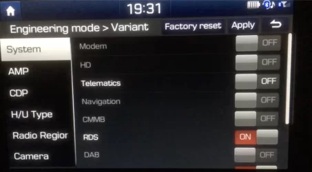

This is typical what I see day after day. Here, after 2 short drives at 1715 and 1815 the BMS is doing a cell balance. This Kona, by the way, does not have telematics enabled in the media centre unit and there's no service here, so no related drain.

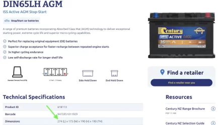

Hi all, after nearly 5 years of trouble-free battery life, we finally made the mistake of not closing the rear hatch hard enough. Car was dead next morning.
Used my jump starter pack and it seems to be hanging in there currently but I know draining a 12v battery flat, shortens its life somewhat.
Just checking that a battery replacement like the Century ISS AGM DIN65LH is appropriate?
If anyone has some experience, good or bad, it would be appreciated.
Thanks

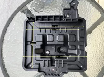

Unless your battery tray is different than mine that is way too long. I bought the DIN44 (AGM) version of that same battery, which is the same physical size as the OEM Rocket.
I would have loved to install a larger battery but I could not see any way to do it in an attractive and tidy way. Cutting the the tray to make that battery fit lengthwise will compromise the tray's structural integrity, nevermind that it will sit very close to other components. The other dims are ok.
