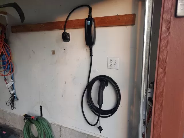

RP mostly with your positive experience in mind I finished up installing a new circuit and went ahead and got the Morec unit. Amazon.ca currently has a $50 off coupon.
It does seem well made, but I have a question. What is the input voltage rating on the back of your unit? On mine it indicates its 230V 50Hz which makes me wonder if it has both 50 + 60 Hz dual frequency compatibility. It powers up fine with no errors but it's screen indicates 239 volts when my multimeter tells me its really 244 volts nominal input. Unfortunately I can't do an actual plug in without my imaginary yet to be built Kona. :)
Looks good enough, although you may want to use 2 hole pvc straps instead of those 1 hole emt metal straps for cord support , as the metal will eventually cut into the cord.;)
Yes, I figured that might be a problem and was I just going to wrap the conduit straps in black tape but wouldn't you know it that I couldn't find a roll for the life of me and I must have gazillions lying around :). Nonetheless, great idea idea about the PVC straps, thanks.

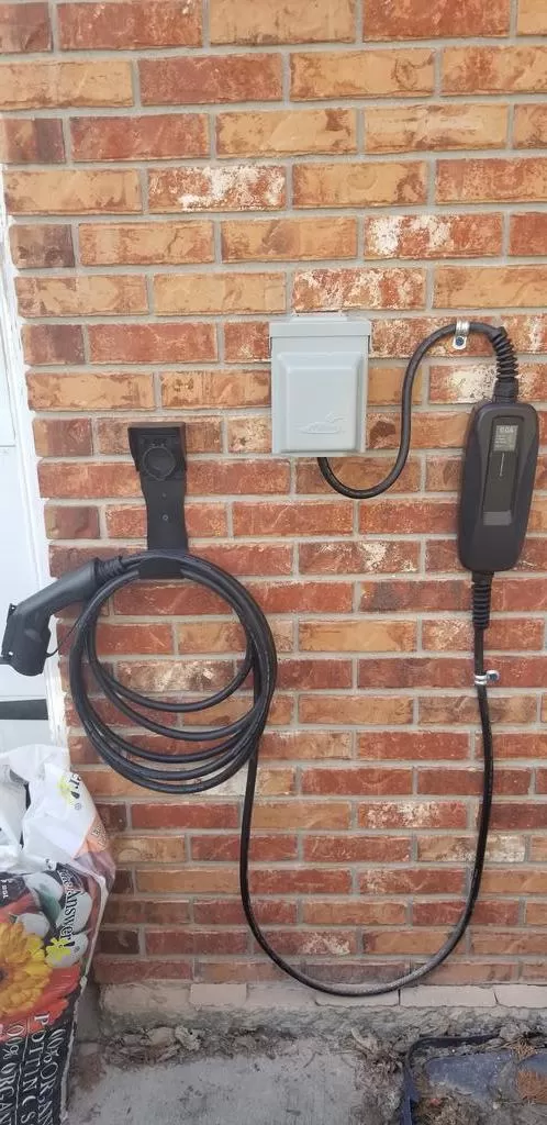

I got a nice holster with my Sun Country charger that locks the cable solidly in place and does a great job protecting it from the weather.

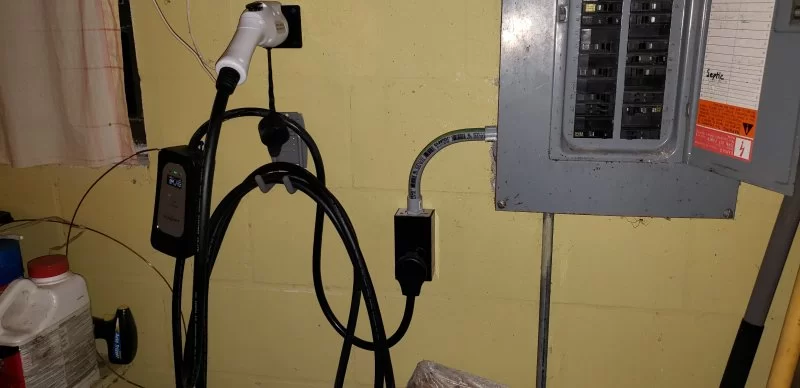

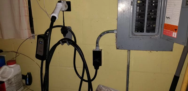

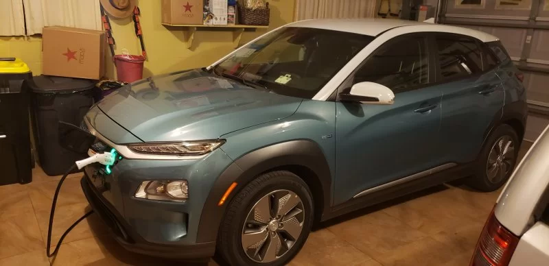

I went with a 26 amp Mustart Charger. I only got a 150 amp panel and the 26 amp charger is on a 30 amp circuit. Installed the outlet right beside the panel myself in 40 minutes. Total cost under $400. I didn't care for Wifi ebabled charger as I can control the charging remotely anyways with the bluelink app.

View attachment 5365 View attachment 5366
you know you probably could have went with a 32 amp and just put in a 40 amp breaker, it all depends on actual load. i have a 100 amp panel an have no issues, but i also dont try to run everything all at the same time
Location?
No offence intended but I sure wish more people would location into profile, get tired of asking the same question.
If you are in a cool location and heating with gas then you are probably OK as far as the electrical service calculated load.
Just keep in mind that 32A continuous *240V = 7680W which is 40% of the total continuous load that a 100A *240V (24000 W*.8 = 19,200 W) single phase residential service can safely provide.
Other continuous loads would be Heat/A/C (the greater of the 2), instant HW, spa etc with demand factors for H/W storage tank and range (in Canada it is classified as any load that will operate for more than 1 hour in a 2 hour period)
I may have been ok with the 32 amp charger anyways.. However, I believe that according to code, you can't have a NEMA14-50 outlet on a 40 amp breaker.. It must have a 50 amp breaker. The difference in charging speed is relatively small. The 26 amp charger is plenty to get my charged up over night especially as I usually only charge to 80 percent unless I plan a longer trip. If I will ever need a little faster charging speed, I'll just change out the NEMA 10-30 to a 14-50 and buy the 32 amp version of the charger. So far, I'm happy with the MUSTART charger.. It was cheap and works flawless..

My charger uses a 30 amp dryer type outlet too NEMA 10-30.. It is 26 amps and charges at 6.1 kwh.. 11 hours for a full charge.

Supposed to not exceed 24 A (30*.8) #10AWG c/w 2p 30A O/C
The wire will handle 26A all day , the breaker won't. Will eventually wear out the overload portion of the breaker-hopefully
The charger I have plugs into NEMA 10-30 and to-30 is a 30 amp outlet. Never tripped the breaker.. If it ever does, I'll go with a 40 amp breaker.. 5 mins work to swap it out..
I would assume then that you ran #8(50A) wire thru that 1/2" pvc 90 (tight fit)
The load is considered as continuous as your NEC 625.41 states:
https://iaeimagazine.org/magazine/2016/07/19/100-vs-80-choosing-the-right-ocpd-solution/
In Canada a continuous load is one that draws for more than 1 hour in a 2 hour period, in the States it is considered continuous if draws 3 hours or more.
When sizing a supply circuit for an EVSE, the proper method is to take its maximum rating and multiply it by 1.25 to size the over current device and wire accordingly.
Example- 32 A EVSE @240V
32*1.25=40
So this EVSE should be fed with #8<50 A> wire on a 2P 40 A breaker for maximum protection even though you could still use Table 13 value and feed it with a 2P 50A breaker for minimum protection.
If your EVSE is rated at 26A then
26*1.25=32.5A - The breaker should be 40A and the wire #8<50>
(Branch circuits) - without EVMS . Only pure resistive loads can have the wire rating less than the O/C device CEC 24th edition 2018 Rule #62-114 sub-rule 8
and of course welders and motors, single phase (all types)motors where the wire is 1.25*FLA and go up, and using a breaker for O/C 2.5*FLA and go down as per T29
Arc welders wire depending on duty cycle and O/C = 2X rated primary current max.
EVSE demand factors may be reduced for feeders and services by utilizing T38
or by using EVMS, 8-106 Subrule 10 and 11 (new 2018)
32*1.25=40
I believe that it is #8 wire.. I actually used the individual red, black and white wires themselves as I didn't need the ground wire as the NEMA 10-30 does not use a ground wire. The entire #8 wire by itself would not have fit through the 1/2 inch conduit but the individual 3 wires did. I will upgrade the breaker to 40 amps..
Changed out the breaker to 40 amp.. I should be good now.. Looking at my chargers display, it shows that it is only pulling 24.6 amps and not the 26 amps the charger is supposed to pull.

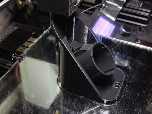

I also went with a Morec Level 2 32A charger. I printed my own holster. Just had the electrical run on Saturday from the far side of my house, now have to wait another 11 days for the car.
cool! did you download the specs for the holster or did you design it yourself?
