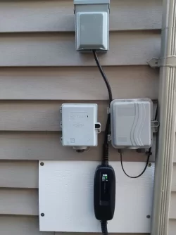

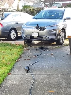

So I have pretty much completed my setup for my Level 2 charger. I live in Richmmond (Steveston), BC Box type of home with a 100amps Power Panel. To top it off my house was built when Aluminium was commonly used so all my original wiring is. As I started Reno's I got rid of Aluminium whenever possible and ran copper. While for my copper plumbing I replaced with PEX but I digress.

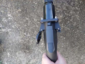

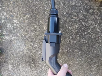

Purchased a MOREC Level 2 Portable Charger 32amps(7.68kWh) with 28foot cord with NEMA 14-50.....I found out this was still too short so I purchased a 20ft Extension Besenergy 40amps J1772. That was enough to get me going from house to car

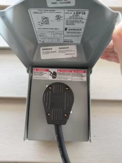

As for the wiring for my house I decided to run a 6/3 wire hooked up to a 50amps bolt-on double pole breaker. It leads to a Talon 50amps Enclosed Outdoor rated receptacle.

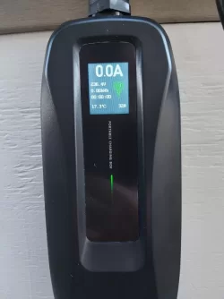

Currently during the day I get an average of 7.15kWh Per 1hour charge. While when I charge at night I achieve 7.52kWh Per 1hour charge. I am happy with the charger itself however I should have listened to someone on this forum and purchased one that's 40amps right away....
BC Hydro rates are $0.0945kWh for first 1375kWh then rates go to $0.1417kWh for anything over 1376kWh.
When NOT In Use I simply remove my portable charger and turn the Breaker OFF so no one can "tap" into it.
