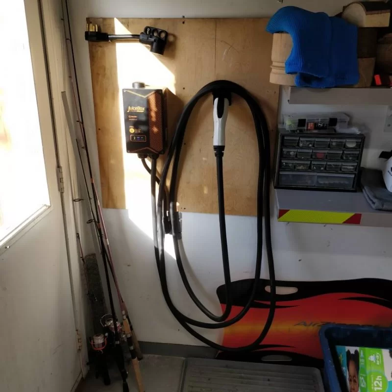

I must have missed this post a while ago. I have had a JuiceBox Pro 32 for a while and if there isn't any wifi connection it will max out at whatever amperage you had it set at previously. If you need to change the amperage because you've taken the charger to another location with a lower wiring capability and there is no wifi, you connect directly to the charger using the app and adjust the maximum. For example, at my home I leave it set for the full 32amps as I have the charger plugged into a dedicated 50amp circuit. When I take it to my parents house, they only have a 30amp circuit available so I log in to the charger when I get there (because I always forget to change it the easy way at home with wifi) and back the charger down to 24amps max.
Hope that clarifies for ya! I love the JuiceBox, very easy to use and heavy duty.
Hope that clarifies for ya! I love the JuiceBox, very easy to use and heavy duty.View attachment 3631

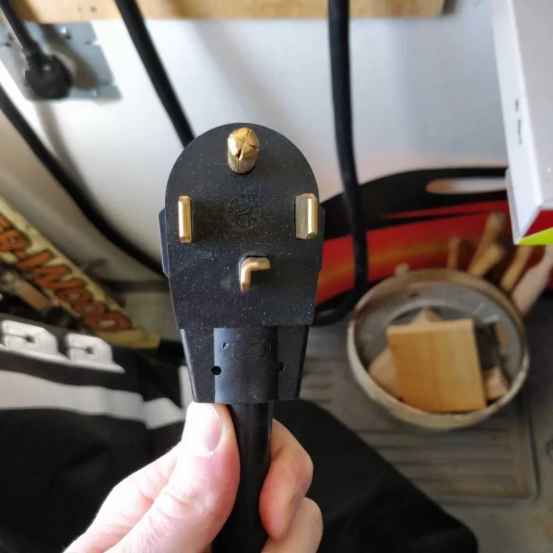

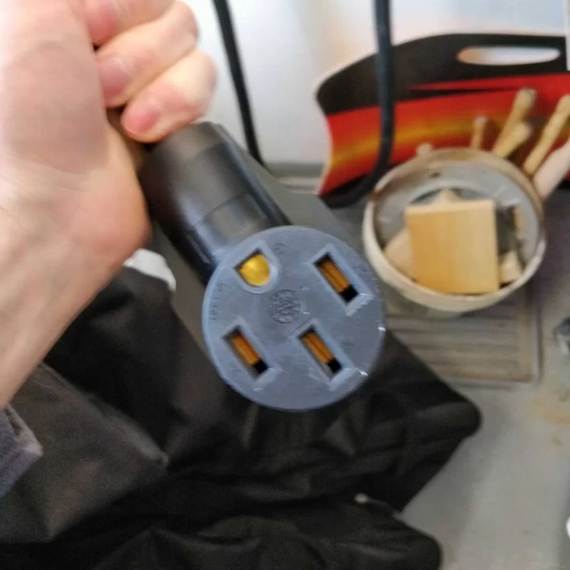

Hey Shawn, what is that plug you have hanging on top? It looks like an adaptor?

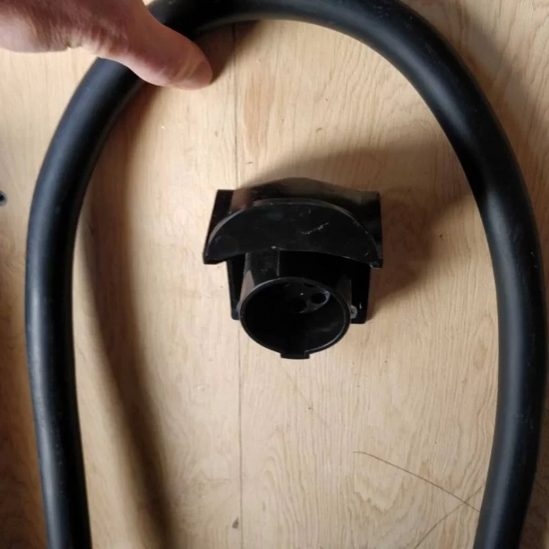

Does the Juicebox have cord storage around the unit, or is that the way you have to store the cord as in your picture?
The charger came with the cord connector and storage piece. The piece up top is an adapter from JuiceBox that allows the NEMA 14-50 JuiceBox plug to plug into a NEMA 14-30 dryer outlet. You just have to dial it back in the settings so you don't burn the house down lol.
The charger came with the cord connector and storage piece. The piece up top is an adapter from JuiceBox that allows the NEMA 14-50 JuiceBox plug to plug into a NEMA 14-30 dryer outlet. You just have to dial it back in the settings so you don't burn the house down lol.View attachment 3633View attachment 3634View attachment 3635
