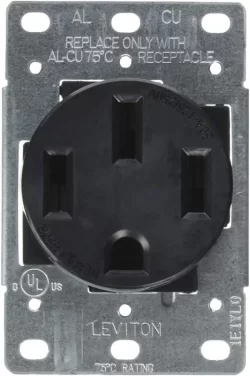

Got my Kona 2020 on Saturday and now finally getting my charger delivered from amazon.ca
Opted for the MOREC 32amp 7.68KW due to the fact it has 28ft cord instead of usual 25. Along with a Leviton 14-50 plug and a 50amp Outdoor receptable. Came to just under 600$ CAD...I dont have a garage old style home BC Box with 100amp panel. So I'll be charging at night when everything is OFF.....
And I like the portability of the charger so I can hook it up when needed at my workplace 220 circuit.
