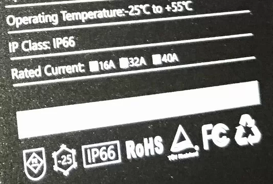

As you are in Canada so long as it has a symbol exactly like the ones displayed on page 8 of the Tech. saftey B.C. pdf page 8, then it is ok.
As an electrician if in doubt, a picture of the symbol on the equipment can be sent to them to confirm, as there are other directives in the BCSA files
that express the concern of counterfeit accreditation approval labels and symbols specifically manufactured in China.
In the picture you provided it does not. Is that a little"c" beside the triangle?
The TUV symbol is EXACTLY as it appears in the BC markings doc. The descriptor below is TUV Rheinland with a little (R) to indicate a registered trademark. On the website and on the box it says it is TUV tested and certified.

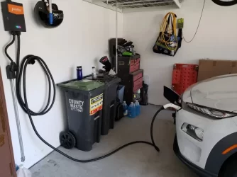

Hi folks, I purchased and installed JuiceBox Pro40 - plugs into NEMA 14-50. I ran the circuit myself, so the cost was $550 for the JuiceBox, about $100 for the wiring and another $125 to have it inspected. Works great, scheduled for off-peak (NYSEG has EV owner rate) and
charges at 7Kw/hr.
