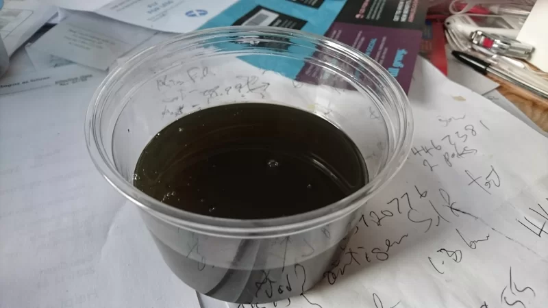

Changed my gearbox oil today at the dealer. Black as black can be. 25K kms since my reduction gearbox was replaced (along with the motor). They filled with non-synthetic 75W90 gear oil which they said is the same as used in the differentials.

Back to the gear oil, I got them to save me some from this change as well. And it is still quite black, but not quite as bad as the stuff from yesterday. It is noticeably thicker, too. The original was more like water viscosity.

Finally did my reduction gear oil swap out this afternoon.
At 8776 km, the fluid was black like everyone else’s.

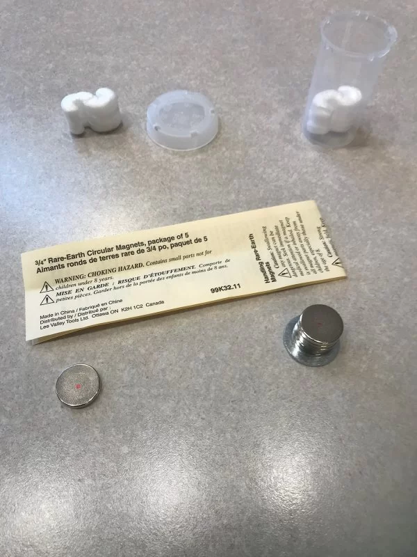

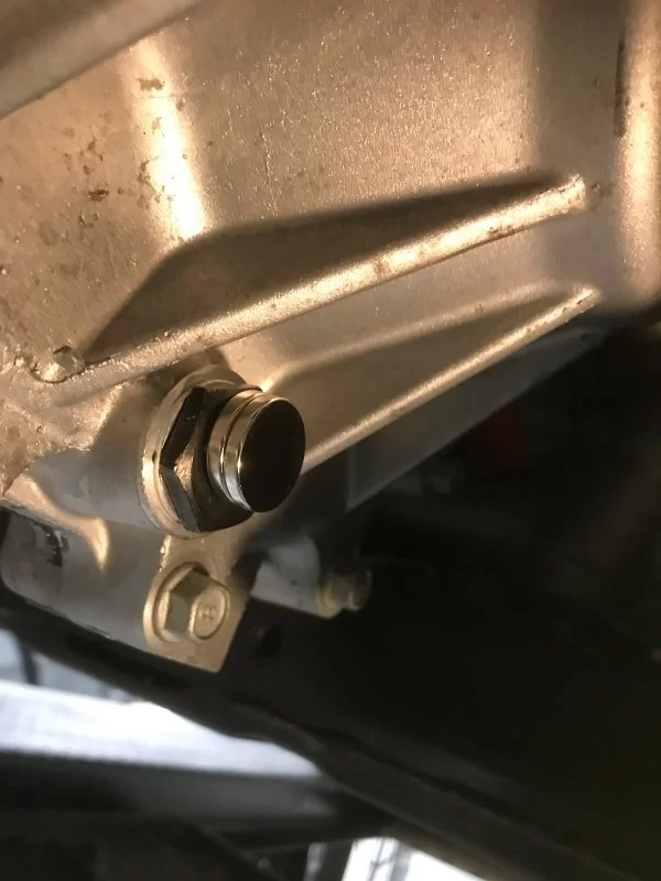

My modified drain/filler plugs:
I used a small square of 3M double sided tape just to make sure any sort of vibration doesn’t somehow dislodge the rare earth magnets.
I used two magnets per plug:

Have just installed the plug and topped off the fluid - last time I put an exact 1 litre in. Today I put more in until it ran out the filler hole - about 70ml.
I feel more at ease now with two magnetic plugs.

Navguy -- for your magnets-on-the-outside thing, did you happen to check how much perceptible
magnetism that actually created on the *inner* surface of the plug before installing/refilling?
_H*
I can’t justify the >$CAD 52 (plus HST) price for 0.95 litres of the OEM 70W product.
Wow, that is a lot. Was that for the 04300-KX1B0 or 00232-1906?
Guess I was fortunate they didn't charge me the extra cost for my 2nd oil change.
_H*
Yes I did.
I used screwdrivers as examples and I was able to have (at least) four screw drivers be held up by the magnetic attraction of the “inner” surface of the plug.
