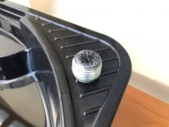

As for the magnet, as I mentioned to recent queries on FB, installing one of any strength is infinitely better than none. Two is just twice times infinity, but that's still infinity. The drain plugs used on my small 4x4 on each of four gear casings have ceramic magnets, relatively weak in today's terms but they keep the oil clean. This is from the manual 5-speed gearbox after 40,000 km.

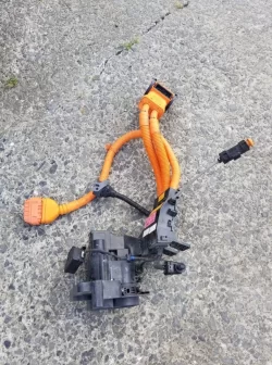

Just one note about out-of-warranty failures, a 2018 Kona owner here with nearly 150,000 km just had the charge port actuator fail and had to pay all costs, just over NZ$2100. We all know that this is a not an uncommon failure and almost certainly due to a design defect yet Hyundai accepted no responsibility. One owner in the UK said this issue was considered a recall item by his dealer.

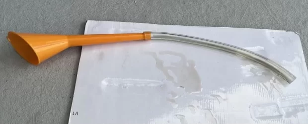

Are you saying you left the rear wheels on the ground, and lowered the front of the car for the refill? How do you get under there to refill it with the front lowered? Isn't it pretty tight?
Yes, but it's not that difficult. You have to have a funnel with a tube attached running from the 12V battery area down to the filler opening. 15mm OD or less to make it fit the filler opening.
Just leave the car elevated and installed a measured amount via the funnel.
Oh, so you can fill it from the top? Yeah, that would make it a lot easier/safer. I just had a peek under the hood by the battery, but couldn't see any filler plug. But I guess the location will be more obvious from underneath when the bottom plug is removed for draining.
A lesson learned when I swapped my fluid out yesterday (and I have a lift):
Using the funnel and clear vinyl tubing as @KiwiME shows, one cannot “route” that tube successfully to the fill plug opening from the top, one must “pre dangle” that tubing from the top and then hunt out its location from underneath to then route it to the fill opening.
The funnel fits nicely between the 12 volt battery and the coolant recovery bottle, but I couldn’t find a logical path to route the hose whilst I was working from the top side…only once I was under the vehicle could I grab the hose and route it through the labyrinth of bits and bobs to the fill hole.
YMMV

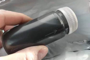

I booked a reduction gear oil change on Dec 21 for my 2021 Kona at the dealership, as I have no desire to crawl under the car!
In the interests of building a corporate body of knowledge in this forum, I decided to order an oil test, to share the results.
This was the first change, at just over 25000 km. I previously ordered a test kit from a reseller for https://www.oaitesting.com.
At Hyundai, the technician collected my sample (see pic). The oil was fairly thin, and black.
I then sent the sample off to the lab in Edmonton, AB. The results came back today by email...
I am not a chemical engineer, and have no automotive training, so I can't interpret the results... Over to more qualified folks.
I do plan on changing the gear oil at least annually, but so far (knock on wood) I've not had any mechanical issues.
I've quoted the comment section here, and attached the (redacted) PDF.
Suggest that diagnostics, additional testing, or other condition monitoring tools be used to help identify the cause of the abnormal wear
condition. Aluminum is at a SEVERE LEVEL; ALUMINUM source in GEAR SYSTEMS may be BUSHING/THRUST metal, ALUMINA SILICA
(Dirt), HOUSING metal or contamination from ALUMINUM COMPLEX GREASE; Abrasives (silicon/dirt) are at a MODERATE LEVEL; Gear
and/or bearing metal is at a MINOR LEVEL; VISCOSITY is LOW for this application; Please provide missing FLUID PRODUCT NAME to
compare data to the correct standards. Please provide missing FLUID VISCOSITY GRADE to compare data to the correct standards. Unit
hours/miles/kilometers not provided for this sample. We acknowledge the FLUID INFORMATION was provided, however we were not
able to validate it within our database or from the fluid manufacturer. Please contact the Data Analysis Department to clarify the
information. Thank you.

... In the interests of building a corporate body of knowledge in this forum, I decided to order an oil test, to share the results.
Thanks very much for sharing the analysis, every bit of information helps.
So, I quickly compared the key numbers to the two other Kona analyses we have:
DaveO_________OzKona______owner #2
25,000 km_____3,700 km_____15,600 km
148 Fe________95___________195
91 Al_________46___________145
51 Si_________50___________65
5.5 cSt100_____5.0__________5.5
Given that you have the highest kms of the three, I'd say you're in good shape relative to the others and the viscosity is spot on. We're not sure as to why the aluminium and silicon levels are high but I also have two reports from Leaf owners and their's are similar. The Leaf gear reducer is nearly identical in design to the Kona's.
Thanks for the feedback/advice KiwiME! I was getting a little worried with the "Red" category aluminum ppm, after reading the various posts here.
I will try and have the the service manager add my report to my maintenance record, so that if I run into problems, I can provide proof of "current" state.

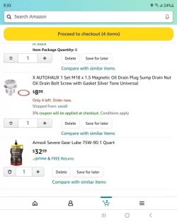

after reading about magnetic oil plug ... I'm getting one ;) although way pass the point of no return for my gears with 97k miles
going with Amsoil Severe Gear Lube 75W-90 what you guys think or should I go with Hyundai stock oil
