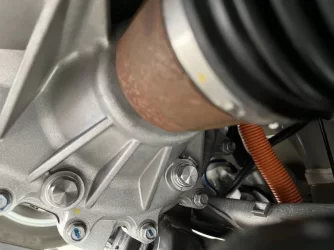

While pondering the oil dripping out of the drain opening a thought occurred to me. It's easy to check for loose final drive bearings while the drain plug is out.
Place one pinky finger fully into the drain opening and touch the gear wheel. With other hand grab either axle and shake it vigorously up and down. The axle shaft will be loose where it splines into the diff carrier but the gear wheel inside should not move - which was fortunately the case with mine. I'm assuming here you're on ramps and the wheels won't turn. Perhaps don't do this if the wheels are hanging free.
Hope that's clear. The gear wheel inside the gearbox should not move radially (up and down) when you shake the axle, despite that the axle shakes inside the gearbox because it's splined. It's a good go/no-go test. If it did move you'd be off to the dealer demanding a new gear reducer.
The pink arrow illustrates where your finger touches the final drive gear wheel if you used the filler hole, the drain hole is much the same. The caveat is that your little finger must be under 15mm dia otherwise it may not come out.

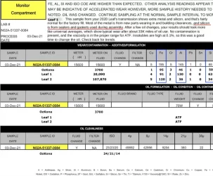

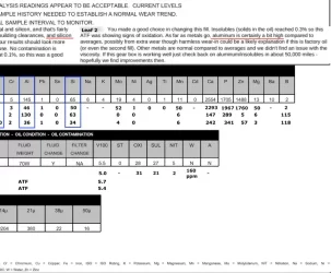

I found two Blackstone oil analyses on the MyNissanLeaf forum and pasted the relevant numbers onto the Kona data. The Leaf gear reducer design is very similar to the Kona's with the exceptions that it has two magnetic oil plugs and runs ATF.
The Leaf's comments are pasted along the top, #2 sounding very much like a fortuneteller's reading. I've broken it into two images, left and right, as before to circumvent forum resolution. I've highlighted in blue the three elements we care about. Based on this I'm less worried about the Kona's high aluminium and silicon values.
Yes, that is certainly reassuring. For me what I hope will be a definitive and favourable result will be my next test at 10,000km, ie in 6000km time. I will be sending a sample of new oil as a base for comparison, together with what come out of the car - obviously using the same Penrite 70W-75 as is in there now.
I do wonder, though, where is the aluminium coming from because as far as I know from intuition, experience and what you (KiwiME) have explained, there are no aluminium wearing parts in the reduction gearbox. Could it be an additive in the oil?
It's probably still housing wear at the ball bearings as we'd assumed but with similar levels showing up on the Leaf it may be minor enough to not be of any consequence. We don't have a good idea yet of how much aluminium in PPM equates to how much visible or measureable wear. And it does seem that failures unrelated to the motor alignment issue show up at the final drive bearing rather than at the primary or intermediate shafts, as what we see in the Russian video. It seems certain that owners who maintain good oil condition are unlikely to ever suffer that failure.
