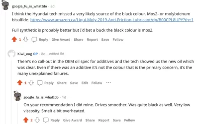

Thought there's no mention of it in the owners manual, is it possible that the gross discolouration in mine at 4000km could be due to an additive like molybdenum disulphide or a graphite treatment? I guess the analysis will tell.
That question came up on Reddit but the owner carried out the change anyway. I suppose it is possible but on the other hand there's no call out in the specification. Even if that was the source of the blackness it's the evidence of ferrous dust that concerns me. Particles of any type are detrimental to oil lubrication because of the cavitation issue I'd mentioned earlier, at least in my experience and understanding.

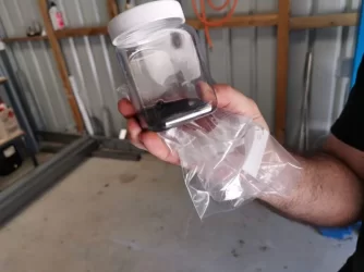

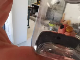

And when you get it done, could you please post some pics of the fluid in a bottle and also in a tray of some sort so we can get an idea of its condition. (Ask your mechanic to keep the sample uncontaminated - maybe give him/her a clean 1 litre bottle.)
On another note I reported this issue on Reddit yesterday and one MY19 owner who has had a replacement at 17,500 km said he thought that the gearbox housing had been slightly revised. Since your example is new it would be great if you can take some photos when doing the job. You might even find a magnet if you pass an old-fashioned compass across the surfaces.
Thats' a me..!!
I have to apologise to Hobbit. You don't miss much and that should have made me think more before replying.
I kinda dismissed your suggestion that there could be non-ferrous particles in there, but having re-read the thread and seen (again) KiwiME's post #137 on P7, I realise what you were probably referring to and I now agree - there could well be non ferrous material in the oil, though I sincerely hope not. If all that stuff is aluminium from a bearing rotating in its housing then I don't hold much hope for a bright future for my reduction assembly. The oil analysis I'm waiting for will presumably tell all.
Here's pics of the oil in my MY19 at 17500kms. What lead me to check was both the milling noise that was apparent in the passenger floor at low speed and the video from The Offroading Mechanic on YT. Also noted was the looseness in the CV shaft...
I reported it to my selling dealer at service. They responded saying it's normal. Clearly they didn't check jack. I got the sample and booked again this time with a sample pot in hand. 6 weeks later I get a reduction box replaced.
But it wasn't the end of this story. 100kms after picking the car up it dumped out the gearbox oil spraying it on the battery underside and belly pan. It didn't empty out the reduction box and it was the seal on the filler plug. Yeah righto.

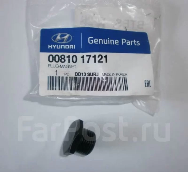

While fielding on-going questions on FB I've discovered that Hyundai make a magnetic drain plug for the DCT (dual clutch transmission for ICE) that looks identical to the original non-magnetic plugs in the Kona. The dealer's parts department told me nothing more than it's "not a part carried by Hyundai NZ." Pretty typical service, no effort made to cross reference the number or explain why they wouldn't stock spare drain plugs. Can be bought off Amazon for NZ$52 however.
Yes, I did quickly check to confirm that the plug I removed a few days ago is not magnetic!
Thanks for the part#, I will ask next time I go in to set up a change of gearbox oil, They were quite busy when I had my service done, will set up appointment early January.
