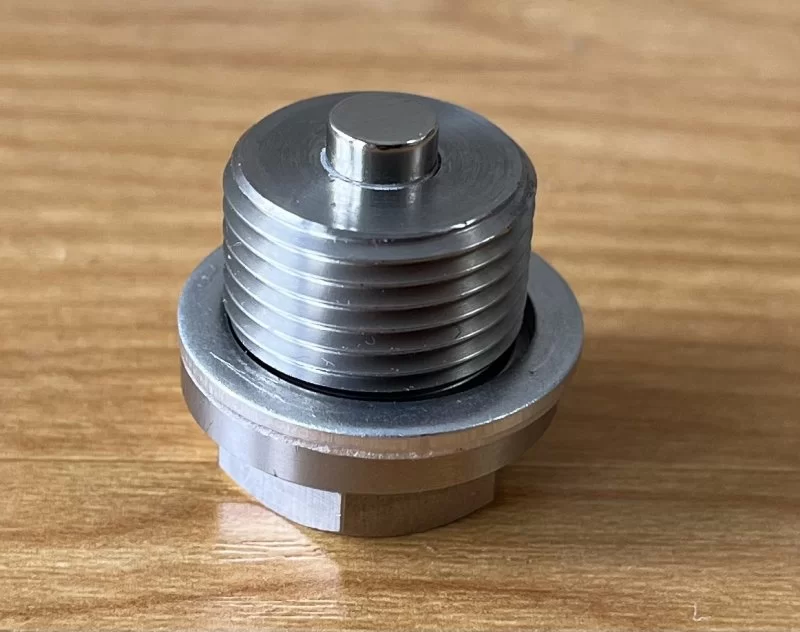

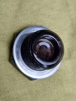

My magnetic drain plug arrived today, way earlier than I'd expected. It does look exactly like the photo. 12mm of thread and the supplied washer is 2mm thick leaving 10mm engagement. I'd prefer it to be longer but it does seem to closely match the length of the existing plug.
The hex is 17mm instead of 24.
Hope to get started on the job soon!

Loctite 609? I think it's 609 - the non permanent stuff. Non-permanent thread locker, anyway.
There's another aspect. Stainless bolt into alloy can seize. You can use anti-seize, but at the risk if promoting loosening, I suppose. Would thread locker help to prevent seizure as well as prevent loosening?

Just for reference, the torque spec is 33-44 lb-ft according to the Hyundai tech on YouTube, aka The Offroading Mechanic.
I’ll try and do this job tomorrow if it’s not raining.
While I'm waiting for the oil to drain out ...

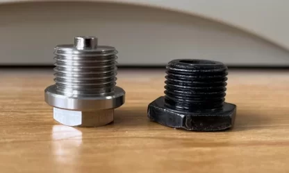

The Votex plug is the same length as the original, 12mm, but the original washer is 1.5 instead of 2mm thick.
I think that's good as the torque spec will be applicable without risk of stripping.

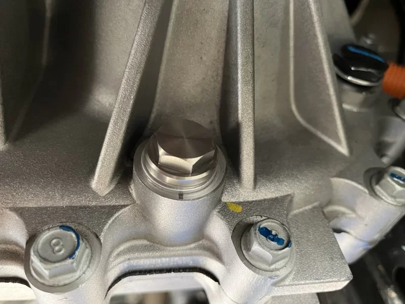

There's over 35mm of room from the washer surface to touching the gear wheel, including a fair amount of thread. That's also good in that it shields the magnet from oil turbulence, as I had mentioned before. I think it's going to be a good mod, kind of wish I'd bought two!

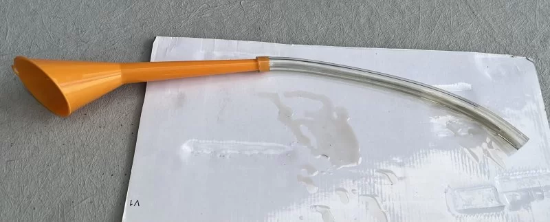

2. Fit a funnel with PVC tubing down to the filler opening and secured funnel near the 12V battery. The tubing was tight in the filler threads but would obviously need to be secured if loose.

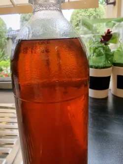

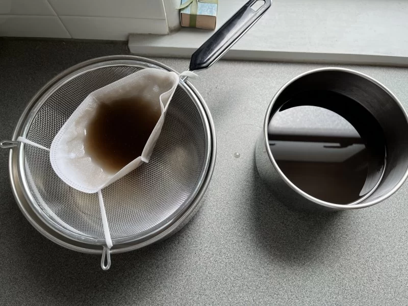

It looked darkish so I filtered it through a period-correct N95 mask over 2 hours. It didn't make too much difference to the colour and there was no obvious debris left behind in the mask.

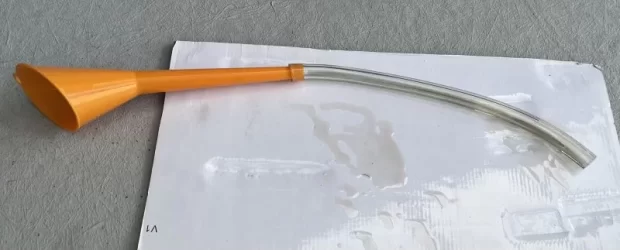

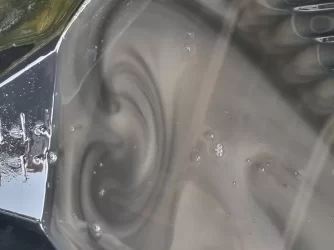

The appearance of the oil in the drain pan worries me. As I swirled it around it was clear that there was a lot of colloidal metal in the oil, so all that early wearing-in debris has been ground up into an abrasive, thin paste. Great. Not.

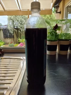

4000km old fluid alongside a measured litre of new fluid (Penrite 70W/75 GL4+) for comparison. (I lost a bit of the old fluid due to clumsiness, hence the different levels in the bottle.)

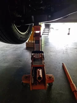

My only note, acknowledging that you have safety stands but more as a warning for others who DIY this, is that I used the same size trolley jack in the same rear location under the lower suspension arm and it slipped out the back (not side) suddenly but caught the rolled edge of the arm preventing it from dropping further.

Thanks. I was not expecting the oil to be clean, but I was also not expecting it to be as dirty as it was. The amount of colloidal metal floating around there is of concern. I am surprised that over a period of 3 years since the model was introduced the problem has not been identified by the manufacturer and some action taken to at least try to counter it.
That slippage would have been a heart stopper :eek:. I used wooden blocks between the jack pads and the rear control arms to spread the load, prevent contact damage and prevent slipping.
EDIT: DIYers, if you use trolley jack in this way be very careful when lowering the back end to just crack the lowering valve and let the car lower slowly at a controlled rate, a bit at a time on each side. If it lowers fully in a rush on one side it will undoubtedly slip on the other and could cause significant damage.

I have no doubt now that every Kona's gearbox oil is as equally contaminated. It's also pretty good evidence that there's no permanently-affixed internal magnet installed in the later version.

The silvery-grey condition of the oil in Ozkona's car was frightening. In any other normal reduction gearbox at 4,000 km I would have expected the oil to remain transparent, free of visible debris but the drain magnet would be loaded with fine steel particles, some splinters and a grey paste due to break-in smoothing of the hobbed finish on the gear teeth. In the Kona those particles remain unconstrained, continually circulating and being crushed again and again by ball-bearing raceways and gear teeth. Eventually particles are reduced to dust, blackening the oil in the process. Finely-polished bearing raceways will develop a matted appearance and the bearings will run noisier but not likely fail catastrophically. Gears are less sensitive but could eventually develop a faint whine as the geometric tooth shape departs from the ideal involute profile. The gearbox could survive the entire service life of the car under these conditions but it will be operating in an unnecessarily-deteriorated condition relative to the accumulated kms.
