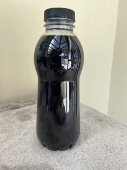

After mulling this over for a few days I'm going to step up and say that I believe Hyundai engineering were remiss in not equipping the Kona gear reducer with a magnetic drain plug. The oil I pulled out of my Kona after 19,000 km was as dark as black coffee and contained a light loading of fine ferrous wear particles.
It's completely out of character for a simple gearbox to discolour oil in such a short time, never mind darken it. Watching the half dozen Leaf oil changes on YouTube, none were nearly as dark (noting that the Leaf uses ATF, already dyed dark red) and the magnetic drain plugs (two on the Leaf) were "chocker," as we say down here. I'll note that it's normal for gears to shed steel slivers, especially when new. In the Kona these slivers will be ground down to dust because of the failure to remove them from circulation. The addition wear caused by that is regrettable considering the low cost of the appropriate magnetic drain plug.
I'd like to have an oil analysis done but down here in NZ that's expensive as vendors market their services to heavy industry, not home DIY oil changers. But, I believe the blackness is caused by wear of aluminium rather than steel or overheating. The only place aluminium can wear inside the gearbox are at the bearing housings, the machined pockets that hold the bearing outer races. Under certain conditions such as light loading and/or high bearing friction the outer races can spin momentarily if not press-fitted. Because the gearbox casing is vertically-split it's likely that the ball bearing-to-housing fit is a clearance rather than a press fit. You can see on the one disassembly video available that the primary shaft bearings stay on the shaft, not in the housing. The final drive tapered rolling-element bearings are different, they have their outer races pressed into the housing because the bearings come apart when not confined.

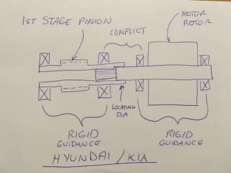

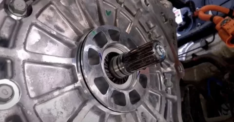

I'm mentioning all this because there may be a connection to the gearbox clicking noises. Here's a potential but totally theoretical scenario:
  • Because of the over-constrained by design condition set up between the motor and primary gearbox shaft splined connection (as I've described once or twice over the past two years and a situation also found in the Leaf but in no other common EV) the radial load in the region of the spline is shared by two ball bearings, the sealed one at the motor output end and the oil-lubricated one at the primary gearbox shaft at the motor end. Good mechanical engineering design practice is to NOT do this. It may look benign on paper but it's an open invitation to trouble down the road.
  • Over a spread of production tolerances there may be some vehicle examples where the gearbox-side bearing becomes lightly loaded at moments in time. That can allow the outer race to spin if bearing friction is sufficient to turn it.
  • Bearing friction can be higher under cold conditions where the oil is thick, or if the oil contains hard metallic debris that finds its way into the raceways.
  • Once a gearbox bearing outer race develops a tendency to spin it will eventually wear its precision locating diameter in the gearbox casing. The wear will produce aluminum debris which will show up as a darkening of the oil. Anyone who's polished aluminium with grinding paste would recognise this darkening phenomenon.
  • As the bearing outer race clearance to the housing increases the load on the spline's locating diameter becomes more severe. Note that involute splines such as this use an adjacent slip-fit locating diameter to keep the spline centered radially when under low torsional loading. Under higher loading an involute spline is self-centering. "Involute" is the shape you see on gear teeth.
  • If that spline locating diameter (greased at initial assembly) becomes worn, now the motor is damaged and won't behave well with a new gearbox. Also, there would certainly be knocking noises produced as the spline and raceway clearance deteriorates.

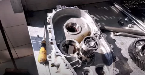

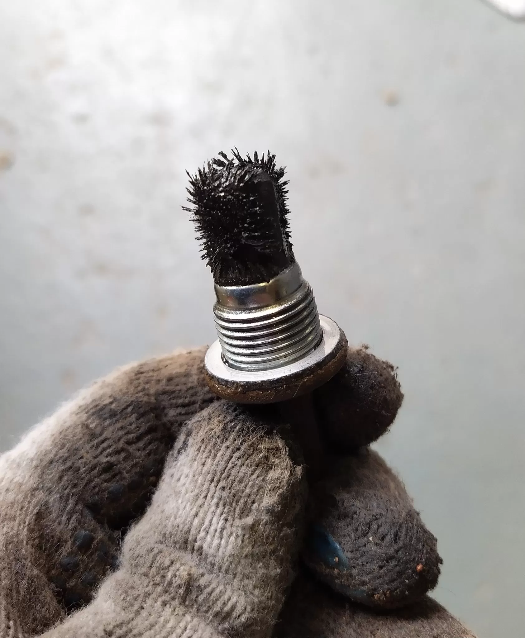

Placing anything “foreign” inside the gearbox would make me very nervous. If it came loose the gearbox would instantly and catastrophically fail, possibly locking up the front wheels.
The ideal magnetic drain plug would have a mechanically crimped-in magnet rather than glued in like most aftermarket ones appear to be.
I’ve been searching online and there are some OEM applications that might yield a suitable candidate. 1980s Landcruisers for example.
Ok, after another experiment I'm thinking the blackening is purely due to ferrous debris being ground to dust due to the initial lack of retention of that debris by a magnet.
The race is on now to find a high-quality magnetic drain plug available in NZ.
