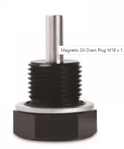

I have ordered this
from Mishimoto. I am hoping it will fit in the filler hole - will test it on receipt - and will also try it in the drain hole when I do the 10k oil change. I like the idea of a larger magnet.

I have ordered this

The Mishimoto plug will fit fine but to a large extent the application details are left up to the customer. I'm not sure why Dowty washers are popular as it's not the sealing that's the primary task, it's keeping the plug secure. Dowty washers are made for high pressure hydraulic applications with steel fittings and I'm unsure if the aluminium surround will deform during the install in our lightly-torqued application. The soft washers we are using now of course deform to match the fine detail of both surfaces and as such are good at keeping the plug secure. Sealing against oil seepage is just icing on the cake.
The long magnet certainly improves the chances of catching particles. It looks like a high quality part but the first thing that I'm thinking about is what sort of material is it (cast or formed) and will it resist the continuous impinging flow of oil. Will there be flow eddies that will induce a vibration and fatigue-stress the magnet in a bending mode? The other issue is differential thermal expansion between the aluminium plug and magnet and how the glue handles that, although the Kona gearbox barely gets lukewarm. My gut says all this is probably fine but my engineering side says don't start off being biased! My conservative take on this, since I don't have the tools to carry out a formal analysis, is that it's more risky than the Votex product and that alone would put me off.
I believe the short Votex magnet will be sufficiently effective. Particles need to be right there at the magnet to stick, they don't get pulled from far away. Every mm³ of oil containing a particle of steel will have a very high probability of momentarily being adjacent to the magnet over a long period of running time, a wild estimate might be every hour driving. That time could be reduced by increasing the magnetic area or strength but it's going to be good enough.
