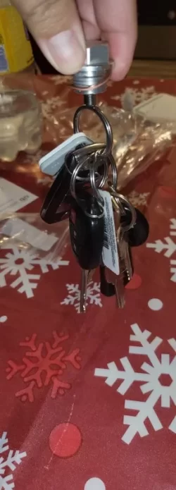

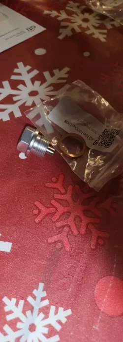

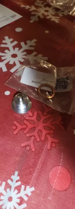

I received my oil (Red Line MTLV 70W75 GL-4 ) last week and my magnetic oil pan plug came in today. From China courtesy of Amazon.
Got say the is really strong able to pickup my heavy set of keys.
Hopefully I'll be doing oil change next week as I was infected with Covid .. monoclonal antibodies are amazing cleared my worse sore throat in my life in matter of hours, doing great now but still taking it easy
... and my magnetic oil pan plug came in today. From China courtesy of Amazon.
I'm very reluctant to risk detering your enthusiasm, especially given your hopefully-short illness, but I'd suggest a little bit of caution with the aluminium drain plug you've purchased as I think none of us have any prior experience with this type in the Kona.
The quality appears good enough but there's always a risk with the differing thermal expansion coefficients of aluminium and the rare-earth magnet, presumably similar to steel. The glue holding the magnet in place will be some sort of 2-part epoxy like JB Weld, and hopefully flexible enough to retain the magnet despite the microscopic cycling of the dimensional clearance that will inevitably take place.
Certainly it's minimal compared with the engine sump application these are normally designed for, as the gear reducer typically runs about 20°C over ambient rather than the 100°C+ that engine oil may reach. However, the outcome in the event of a loose magnet in an engine application is far less worrying than in the gearbox application because the only magnetically-attractive items inside a gearbox are gears.
Dimensionally it looks fine and in reality the magnet will be held tight simply by the vacuum resisting it trying to leave the aluminum body. If it seems secure enough before installation it would pay to check it after a few months to be sure it's still happy. You could install it in the "fill" opening instead of the drain as it will be easier to inspect and will still be equally effective at catching ferrous debris.
