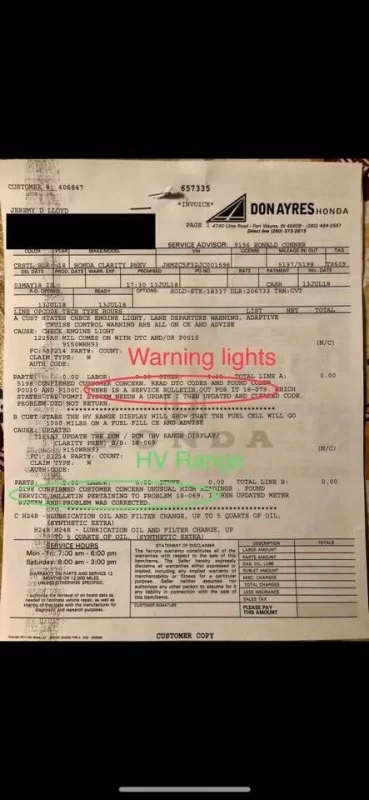

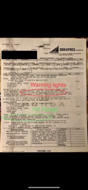

And this looks like the fix ... I should mention that I have not had this issue either...but seems like a big concern...as for the inaccurate HV range... I drive mostly all electric...so I won’t be rushing into the dealer either...
And this looks like the fix ... I should mention that I have not had this issue either...but seems like a big concern...as for the inaccurate HV range... I drive mostly all electric...so I won’t be rushing into the dealer either...View attachment 1561
Can you make out the Bulletin Number? I haven't been able to by zooming in. I'm also having second thoughts about waiting on this one. As you say, this one seems like a big concern, and I would much prefer to not encounter it, or have my wife cope with it.
Ken7, I’m also not having any system warnings. For those of us who don’t have any problems, are we supposed to get this update??
18-079
