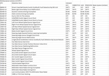

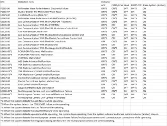

Attached is a list of all of the system warnings that certain DTC's will throw. It seems to give credence that if the car senses a slight deviation in the camera system, it will give the Multiple Sensor Warnings even if it doesn't store a permanent DTC. Someone on Facebook indicated that the dealership cleaned the camera systems and her warnings went away.
