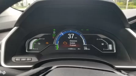

Joining the club this morning. Received an Emissions System Problem error this morning. Stopping by dealer to have car looked at .
