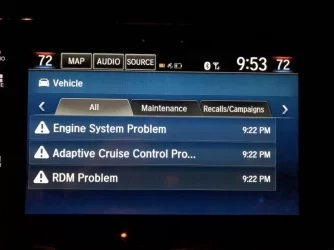

Just got similar issue on my clarity 2018 from last Friday, with three problems about ACC/RDM/Emissions, they were disappeared once their selves on Saturday afternoon, but kept all the time after then. I'm lucky to get all shared information above this morning, and then processed all possible actions I could down by my self: Changed light control to Auto, Re-covered oil cover, and drive the car for Lunch with all problems there; when I start the car for back office, I did carefully put the start bottom and then release it very quickly - so happy to see all warnings went OFF, the car gets cleared as before.

Hi All -- Joining <The Club>. Our errors [CEL, RDMS, ACC, Emissions, Brake system] came on when starting <Clarabelle, 900 miles> yesterday and cleared on the sixth or so restart after giving it a good rest prior to the "successful" start. Dealer is checking and I'll confirm what they report here. I'll mention it has been hot around here recently, since that seems to be another common theme.
... Dealer is checking and I'll confirm what they report here.
The only retained error code was: "P100C stored in the PGMFI system"
Action taken: Ran VTC test on the HDS system and also removed connector and checked pin fit for the electric VTC actuator. No issues found.

As an update, we brought the car in to the dealer service center on Saturday, and they seemed to be aware of this type of issue already. Did the inspection anyway, and came back with codes "P0010 and P100C", with the followup action that they'll call to set an appointment when Honda has a new software update. No ETA on when the software update might be available, though.

As another datapoint, we just bought a new Clarity PHEV base model last week, and it ran great for the first 200 miles or so. After parking for about 30 minutes outside on a hot (~93F) day, the car started up with almost every diagnostic light on (similar to what others on this thread have reported, list below), even though it drove fine getting home.
Turning it off and on again did nothing the first 5 times (on the side of the road right after it happened, then four more times in our garage over a 24hr period at various hours of the day/temperatures). On the 6th try without having done anything different, the warning lights suddenly didn't come on (mid-afternoon, in the garage).

List of lights/issues we saw:
1. Unable to switch between econ and sport mode
2. Emissions Systems Problem
3. Check engine light
4. Road Departure Mitigation System problem
5. Adaptive Cruise Control problem
6. Brake warning light (strangely, though, the electronic parking brake still works).
We did check to make sure the front-facing radar was not obstructed, but even if it was it doesn't seem to account for the inability to switch between econ/sport mode or the emissions/engine lights.
Disconnecting the negative terminal of the 12V battery and waiting ten minutes cleared the triple errors for me yesterday. I did get the TPMS and VSA error at the next power up, but those went away with the first drive. What was interesting was that the EV range reset to something like 42 miles range on a full charge, when before I had about 58. It was funny watching the EV range actually creep up as I was driving (65mph on the freeway no less) then plateau and slowly come down, such that the remaining range registered 35 miles left after I drove a 25 mile highway trip.
