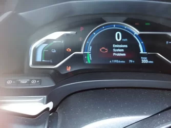

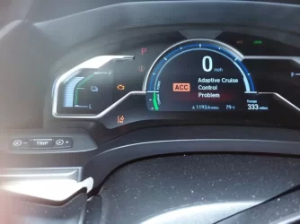

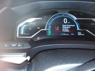

In April 2018, I purchased my Clarity Hybrid EV and have experienced this same series of fault warnings twice now. Although I would rather that there were no issues with this vehicle, I am extremely happy that I found this forum with others experiencing the same problem. So, I'm not the only one having this issue as the deal says...shoo! I have attached some photos of the dash, showing the crazy sequence of faults being displayed.
At this point, I think that K8QM has the best guess at what is causing this problem. I was also considering the possibility that wiring harness could be faulty, although it would be strange for it to be affecting so many cars. My second guess is that this is a firmware issue, as I have seen this before with my 2015 Dodge Promaster Eco Diesel. I found the best info for the Promaster on the Promaster forum, including a service bulletin that the dealer was not aware of.
From what I have read it looks like there are NO solutions at this time, but we are all hoping that Honda will get this figured this out soon.
By the way, I love this car and hope that a solution is coming soon.
