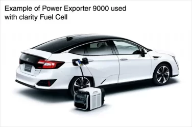

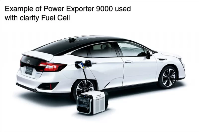

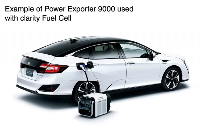

I’m in a power outage so what else is there to do?
If only you had a Clarity Fuel Cell and a Honda Power Exporter 9000, you'd have all the power you need!
http://world.honda.com/powerproducts-technology/engineer-talk/PowerExporter9000/
