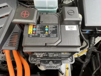

It pays to do the research up front rather than let this catch you out. The metric size is DIN44. The commonly-used North American size is 26R. The difference that I can see is that the terminals are recessed on the metric type, so yes you will have to stretch the ground lead on the 26R.
There may also be the option to use an AGM-style which in theory is better. But in NZ it's more than double the price so I'll stick to the flooded maintenance-free, as per the original Rocket. It doesn't look easy to fit a larger size which would help with the issues owners often see.
But, mine is still chugging away at over 4 years now. Having a battery voltage logger may pay off as I expect to see more elasticity in the voltage excursions day to day as it deteriorates. And if it's not holding 13 volts after a charge I'd suggest an hour on Utility Mode to give it a boost.

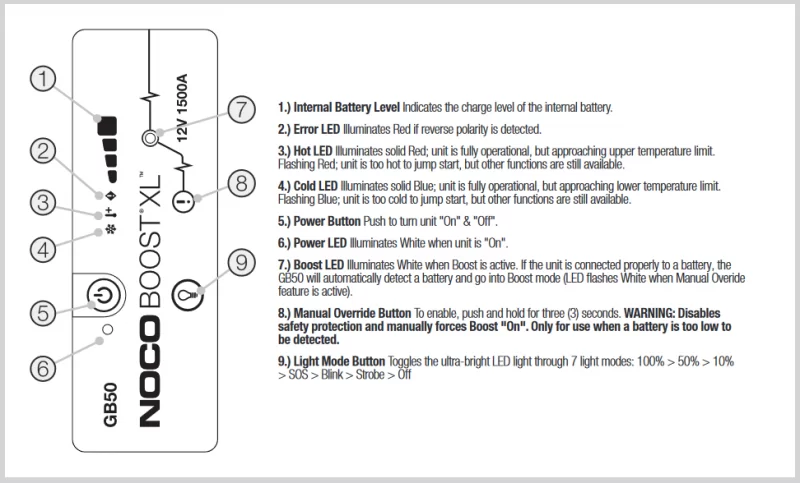

Thanks. I followed the instructions carefully and readjusted several times. My charger indicated that if the charge was under 2 volts it might be a problem but it seems it was at 4 volts. FYI It's a 750 amp pack charged to 100%. I'd rather keep it for future use but if there's a reason for it not to work then it doesn't make any sense to spend the money.
*Edit - I didn't try boost mode because the pack recognized the battery and the green light was on - plus the directions kind of scared me off trying with all sorts of warnings about how dangerous it could be.
Now that the battery is charged I'm assuming there's no way for me to actually test the (potential) efficacy should it happen again?
So, assuming LED 5 was 'on' (what they later refer to instead as a "boost" light) the only thing you could have tried perhaps was to leave it for a minute?

You have to use the boost mode. I had to do that for my dead battery

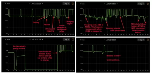

After a long period of truce between me and my 12v battery, it's discovered a new trick:

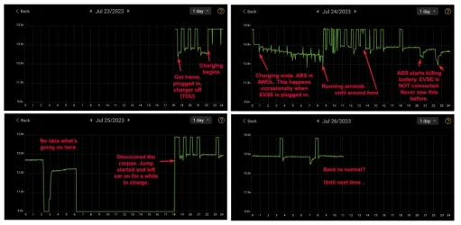

I'm used to seeing the 12v battery die occasionally when the EVSE is plugged in (as at 01:00 July 24). So I just don't leave it plugged in much.
But I never saw Automatic Battery Saver turn into Active Battery Assassin without help from the EVSE (20:30 July 24). And WTF happened after midnight on the 25th?

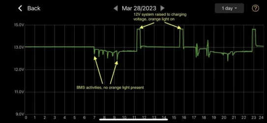

The pattern following that time looks somewhat like what happens with an open or ajar door or perhaps even the hood. The 'ABS' is disabled and there are periodic high loads that seem to match the times when an ABS should start. A bump on each door while the car is sleeping and unawares might reveal something.
The pattern from end of charging is similar to what I see but far longer. I think it's checking cell voltages or perhaps setting up periods of cell balancing. It's a matter of luck as to when the 12V battery gets a 20-min charge cycle. Sometimes one shows up during the BMS maintenance interval in which case the BMS just carries on when it's done. About 3 hours after a traction charge completes is often when I see the lowest 12V battery voltages.

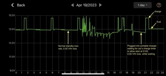

I have noticed a higher discharge rate when the portable EVSE (a 'Ratio' brand, supplied with the Kona) is plugged in and waiting for the in-car timer, noted in the first graph below.
From what I've seen the repeated 'ABS' events at every 1 or 2 hours are due to the car understanding that the 12V battery had been depleted below a set limit prior to the last charge. I'm seeing a lot more now which I can only assume is due to the age and therefore reduced capacity of my battery.
I don't think any door was ajar, though I can't be 100% sure.
Is the 12v battery bad now? (The definition of "bad" is that the dealer will replace it before the warranty expires in 10 months.)
The periods of load every 2 or 4 hours from around 20:20 took the battery from 12.88v to 12.77v to 12.71v to 12.22v and then to dead (under 7v). Looking at a SOC chart, that should be from 100% SOC to 90% to 85% to 50% to 0%. If the load was the same each time, is it safe to say that the battery is bad?
OTOH the two load periods that went 100% -> 90% -> 85% were at 2 hour intervals and lasted 20 minutes, while 85% -> 50% -> 0% were 4 hours and at least the first one lasted 30 minutes. So it's possible the load was higher in the last two periods.
At the moment I'm not seeing any evidence to blame the 12V battery. This is what I would suggest:
1. Check the traction battery cell balance for anything over 0.04 V deviation, preferably at 80% SoC or higher. Significant cell balance deviations may be triggering excessive BMS attention.
2. Assuming you're parked in a home garage, leave all the windows fully down and let the car go to sleep, an hour is enough, leave car unlocked. Switch on your BM2 and monitor the battery voltage in real time (on the first screen). Sneak up on the Kona (without having the key fob) and wiggle the doors one at a time up and down, in and out, by grabbing the inside handle but don't open any. The hatch and hood as well. Watch the dash for signs of a door open or ajar light, and the BM2 for sudden voltage changes. Obviously we're looking for a flaky switch.
3. If practical use the factory portable EVSE for charging and post BM2 graphs over a few days. You could mark them up with periods driving, parked-not-plugged-in, and parked-plugged-in. Post them individually so they're readable on this forum.
