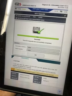

Huzzah! I'm having a very similar problem (12v battery has died four times in the last 3 months). The dealer serviced it in July and said the 12v battery was healthy but they applied an ECU upgrade (901.OS EV Battery Logic Improvement (BMS) - photo attached
