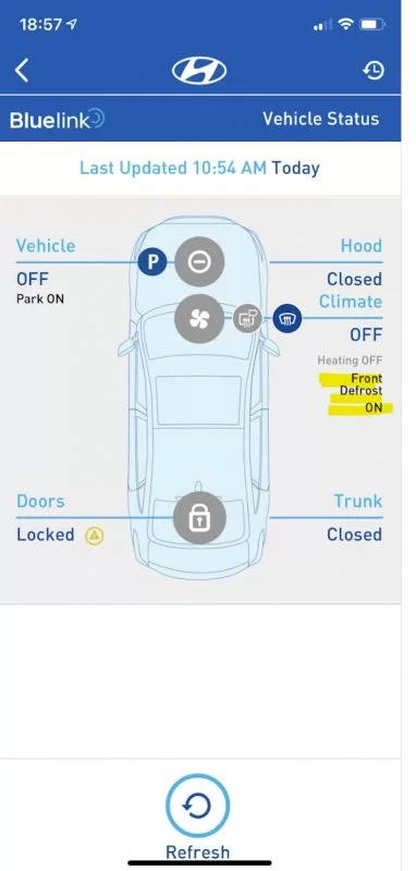

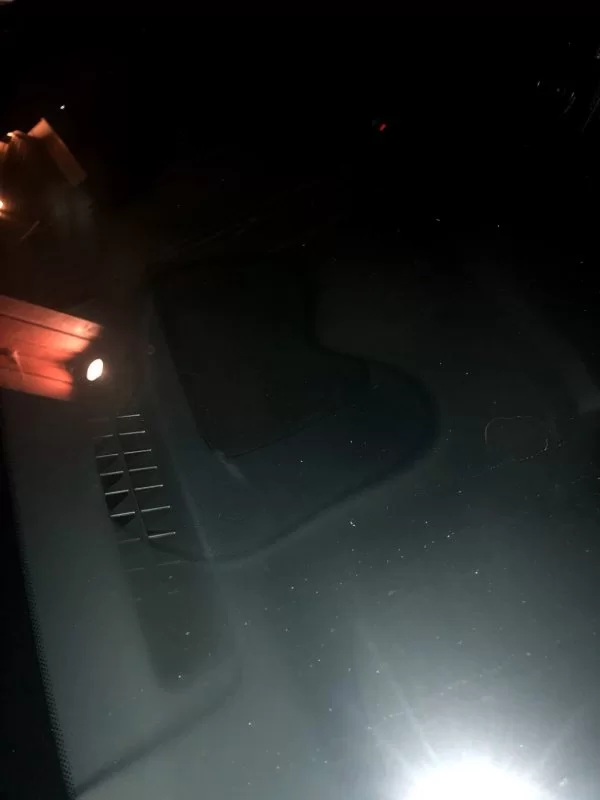

Hi All,
I have a 2021 Kona Electric with about 600 miles on it now. I have had the 12v battery go flat twice.
Electric cars aren't new to me and I do have another one which I have had for about 4 years and never had a 12 v battery issue.
I did some further testing and think I may have found out the reason for the 12v battery drain.
The first time it went flat was 4 days when I was out of town and it didn't get driven, I had left the car plugged in but upon my return it would not start. A jump with another 12v battery resolved the issue.
The 2nd time was after just leaving the car 2 days without driving it this time it was not plugged in. I started doing some testing and I think it might be related to the remote start with climate control.
When I do a remote start with climate control (turning on all heating options, I use the preset Winter option), it is usually super early in the morning, around 4:30am and I'm in the car by 4:45am and away. However a couple of time I have set the remote start, and then had to not go anywhere, so I did a remote stop of the car and got the confirmation that climate had turned off.
The other day I did a remote start in the morning, ended up not driving and then that night I noticed that windows had fogged up, expect for a couple of small patches on the front window. Upon investigating and doing further tests it appears that when Remote Start Climate Control Stops on its own, or you send the Stop command it doesn't seem to truly turn off.
Below you will the spots on my windshield, along with what the vehicle status is via the BlueLink App.
You will notice that while climate control has turned off (yellow light is also no longer on at the front of the car) the Front Defrost is still on. I suspect this is draining the 12v battery. The car appears silent, the fan isn't running and there are no lights on inside the car.
The 2nd image shows the area where the Front Defrost appears to be on.
Unlocking and starting the car and turning it off again seems to turn off the Front Defrost.
I have not had a chance to call the dealer yet, but will do that next week.
Just wanted to mention this here incase this could be the cause???
Would be great if some others could test this theory out.
Thanks

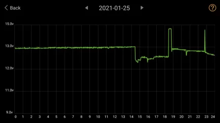

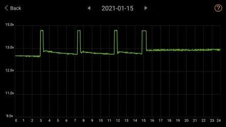

I was hopeful that the first of the battery management system code updates done at dealerships would fix the dead 12V problem, but I went camping soon after getting that update done, and was disappointed. The camping trip ended with an unresponsive car that would not recognize the key, which was puzzling until a Prius Prime owner I was chatting with volunteered his idea. "No matter what the problem is, start by charging the 12 V battery." Sure enough, he gave us a jump and then all was well. :(
Soon after I got a tiny bluetooth voltmeter that velcros to the 12V battery and reads out voltages to your mobile. It's not perfect, but it gives you some insight into what the batteries are doing when you aren't paying attention.
3 screenshots from the battery monitor app follow. But I should say, these are the most regular and normal days, with no driving and no charging. When I drive the car, charge the traction battery, run the climate controls, or if the day of the week contains the letter r, things get weirder. I'll let you know if I figure it out!

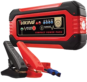

I bought a compact jump starter the first time it happened, and consider its use a normal occasional part of owning this vehicle. #HyundaiBetaTester
This one from Harbor Freight is 6" long and starts the Kona just fine.
