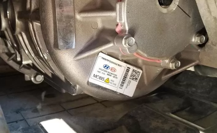

Finally had my traction motor replaced today, after the failed 180 degree driveshaft rotation procedure several weeks ago. I am happy to report this has finally fixed the problem. Drove home in blissful silence. My invoice had oddly very little useful information. It only listed the part number for the old version motor(36500-OE700) as replacement and 3 units(3 gallons?) of the special blue low conductivity coolant(07100-J2A20). They noted a coolant bleeding procedure and motor resolver relearning after the traction motor replacement.
I was kinda surprised they used the original revision motor, so I had a look when I got home and in fact it has the new 701 revision, according to the serial number it looks like it was manufactured on April 30, 2020 in Chung Ju Korea

Nice. Welcome to the 701 Club :)
Based on apu's motor build date, it looks like there is now ample supply of spare motors. At least 3 months worth of possible inventory.
The e711 motor (equivalent to Kona's e701) that I received on my eNiro last year was only 2 weeks old when dealer finally received it after 6 weeks waiting.
