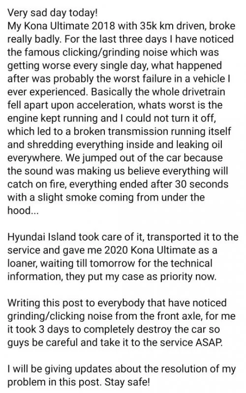

I know some have been able to drive their vehicles for a while after hearing some symptoms. I just saw this posted on a Facebook Kona Electric group and thought I should share here because it seems this can escalate quickly in some case.
Here, they indicate 3 days.

Wait. They're referring to an "engine" and "oil". Are we sure this is even a Kona EV?
It was in a Kona Electric Facebook group. I assume they're calling the motor an engine and the gearbox a transmission.
Now I wish I'd have linked to the group. I'm pretty sure there was more context to make it clear it was an electric Kona.
