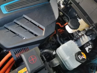

I've tried putting the recorder lower to try and isolate where it's coming from. It seems to sound the same as when I place the recorder on the top of the motor mount.
Here is a recording with no Vess.
https://www.dropbox.com/s/m2k3b2b1ts5v2e1/HyundaiKonaEV_NO_VESS_NOISE.wav?dl=0
Much clearer, I assume you pulled the VESS plug at the front end under the hood?
Yea, it made it easier to hear the issue.
