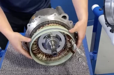

I always watch Munro Associates videos but I believe uncovering this problem is outside Sandy's expertise as a tooling and production engineer. This other video shows the Model 3 motor disassembly and you can see how the motor has no dedicated bearing on its output end, rather using the nearby pinion bearing for radial support. The section with the spiral oiling grooves is intended to locate precisely inside the pinion shaft while obviously the splines transfer the torque. This design gets around the over-constrained problem that the H-K design unfortunately dives into head first. The be fair however, I believe Tesla had problems in this area with their early Roadster design and learned the hard way.

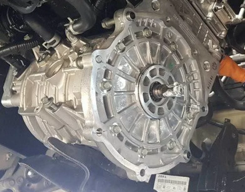

Got a call from my local Hyundai service desk and I was told that my car need repairs and they needed to order parts. I ask what parts specifically and was told it is the reduction gear assembly and the parts are on back order with no definitive ETA. A short while later I spoke to the service manager and he said that according to Hyundai they needed to apply a specific type of lubricant to the motor/reduction gear assembly and that should fix the incessant clicking.
The service manager said Hyundai issued a TSB for this specific problem and then explained that Hyundai will only authorize the release of a $10K traction motor (he mentioned several times the motor was $10K) if the lubrication or reduction gear replacement fails to remedy the issue. Reading about others who experienced the same issue, I am not very optimistic that lubrication is the solution. Now I have to wait for the lubricant to arrive and be applied and then confirm a fix/no-fix before they will replace the reduction gear assembly and then hope that fixes the issue. Only if all of the above fails will Hyundai authorize the traction motor replacement.
I will continue to post updates as I get them.
That is a new one, first mention of a "special lubricant". I wonder how long that will hold up before the motor is eventually replaced?
Looked in Auto Repair Source database and could find nothing on this new procedure.
I suspect they're referring to the grease applied to the splines on assembly.
