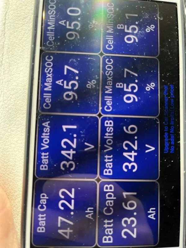

was there another thread for the the readouts? My spring readings at 52250 are :
was there another thread for the the readouts? My spring readings at 52250 are :View attachment 15998

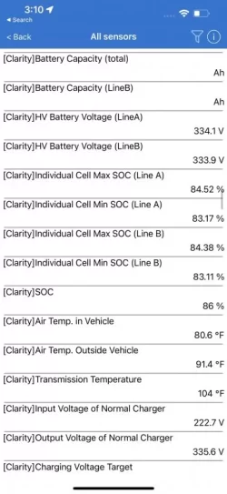

I can't seem to figure out how to check capacity. I have the scanner and downloaded Car Scanner and paid for the premium version. The amp-hour does not show up.
I uploaded a screenshot. I'm getting terrible range 27 on a full charge. Empty battery to full charge only taking 11.4 Kwh. It doesn't seem right.

You are showing the correct screen on Car Scanner. Please elaborate on precisely which OBD adapter you are using. My suspicion is that you have a device with limited buffer size and that's why the reading isn't available. With a little more information I am certain we can get a reading for you.

It is highly likely that your adapter is not capable of reading the larger messages provided by the Clarity.
More expensive definitely does not mean better...
I would consider it a waste of time, but if you really wanted to be certain about your adapter, you can try the test that is shown in an earlier post in this same thread here - https://www.insideevsforum.com/comm...ery-capacity-readout.10531/page-2#post-123944
Do this test, and send a screenshot of the result that you get....
My best suggestion is to purchase the tried and true adapter that we have proven to be good (and most everyone here is using). This post shows specifically what to look for when purchasing one. They are only around $30:

@Jamchow175 ,

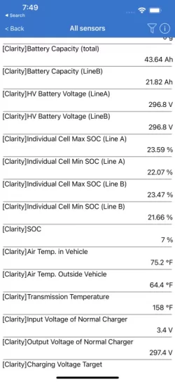

It looks like you are right. I used a different adapter and got a reading, 43.64 AH.
It looks like mine has mine has degraded quite a bit more than the other posters at 72,000 miles.
I charge level 2 as much as I can and do about 80% EV with occasional long trips with gas.
I'll keep monitoring for degradation.

There have been maybe 4 or 5 battery replacements reported in this forum. I don't believe any of these have been due to loss of capacity. One battery was called back by Honda (it was fairly early on, and the owner wasn't having any problems). It seemed like Honda may have observed something via telemetry and they wanted to investigate. Any others that I can think of were outright failures, seemingly due to other components within the battery pack such as the inverter, etc.
Your capacity of 43.64 is down about 20% (and consistent with your full charge energy input). A capacity 'failure' is a loss of 33.3% (1/3 of the original capacity). If your original range was ~41 miles, then a 20% drop should still give you a range closer to 32. With a lot of hills and 70-80 mph, you are pushing the Clarity and I'm sure that's why your range is less than many of us.
We are all very interested in battery longevity of course, and that's why we are doing this characterization. I was thinking that degradation would not be linear and would level out over time. I am not sure we are seeing that yet. I put your reading into the spreadsheet as best I could. Please feel free to add any additional information and assist us by contributing going forward !
I wouldn't bank on scoring a replacement battery... I don't believe your degradation is 'quite a bit more than other posters at 72K' at all. We don't have a lot of users yet with that many miles to draw a conclusion from.
