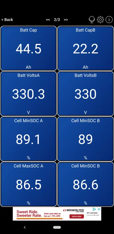

vgate iCar Pro with Car Scanner:
2018 Clarity Touring
56,595 miles
Avg EV range is 33
Lvl 1 charge daily
Battery capacity: 44.5 View attachment 11037

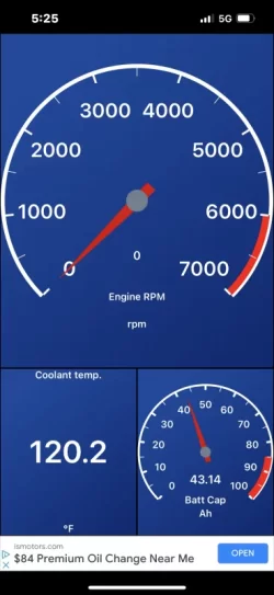

vgate icar pro with car scanner
2018 Clarity
65,858
AV EV range 40
LV 2 Charge Daily at Home and Work
Almost All Ev miles
Battery capacity : 43.14
