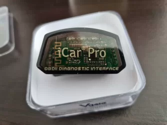

I'm using the Vgate Icar pro BLE 4.0 and it works great. However, it is now $7.00 more at Amazon than what I paid. You could buy that now and I'm sure Mr. Fix It will answer the rest of your questions in the PM.

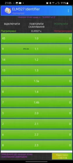

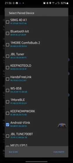

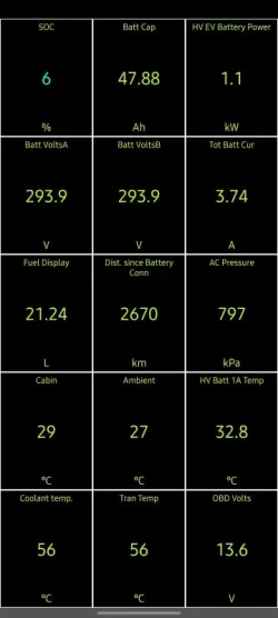

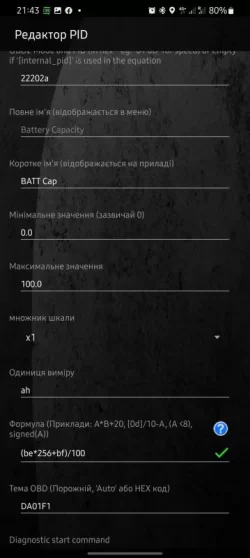

Hi all! For those who were looking for a link to aliexpress to buy an adapter - here I bought it, very quickly delivered, worth 16 bucks. I'm from Ukraine, we have a lot of cars from America and Canada here :). Regarding the topic - I could not get the battery capacity using Torque Pro, although I entered the parameters correctly on the first page. Why? The adapter's buffer is not cut off, I'm attaching screenshots of the settings. But everything worked out with the Clarity PHEV profile in the Car Scanner application. The readings are as follows - capacity 47.88Ah, mileage 96640km, year of production 11/17. The mode of use is unknown, I will assume 75% EV.
20220802_144053.webp 20220802_144105.webp 20220802_144118.webp 20220802_144126.webp Screenshot_20220802-210549_ELM327 Identifier.webp Screenshot_20220802-211334.webp Screenshot_20220802-213658_Torque.webp Screenshot_20220802-214328_Torque.webp Screenshot_20220802-214346_Torque.webp
As we stated in this forum, Torque Pro does NOT work. Your screenshot is just demonstrating that the iCar OBD2 adapter does not have a buffer problem. We already knew that... The problem with Torque Pro is internal where the offset required to obtain the Battery Capacity is too large for the App to handle and it can't get to the correct data word. Stick with Car Scanner.
It turns out that Torque Pro worked when the screenshots at the beginning of this thread were created, but now it is "broken"? ok I will use Car Scanner, thanks!
