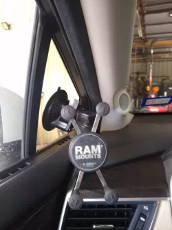

Hey @Reyn, can you say exactly where at the left of the board you put the old phone? (or post a pic?) I'm having a bit of a hard time figuring out where to place it that I can see the screen and it's out of the way of a possible airbag deployment... Thanks!
My wife took the Clarity to work today. I will try to remember to take a photo and post it later tonight. But in the meanwhile let me give you the link to the mount i used.

The phone with the OBD data is mounted on the left side of the dash with the suction cup on the main dash, the support bracket on the lower dash. See product link above in the previous post.

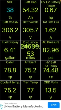

I finally took the plunge and bought a VGate Pro BLE OBD-II scanner and loaded Car Scanner on my iPhone and your instructions worked like a charm, @MrFixit. Thanks!

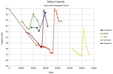

Maybe I will cull through the capacity data and make a plot showing every example of a 'reset' and how these are 'recovering' [or not]. Most do not experience this, but there are enough to make this a serious question.
I looked at all the Battery Capacity data. There are 5 users who I believe have experienced an unexplained capacity "Reset".
All are "recovering" (some faster than others). @Clarity Dave is the most recent, and thus has not begun to recover yet. Please continue to monitor so we can learn more about this odd anomaly...
Here is a plot of these 5 users:

With respect to the 2-phone dilemma, I have a slightly different problem. My primary phone has developed a bit of slop in the USB-C connection. I no longer get the tactile and sometimes (barely) audible click when plugging in. Coincident with this, the car absolutely refuses to acknowledge AndroidAuto. I can still successfully charge the phone, on a desktop or what have you, have not attempted to in the car while in motion but suspect that would meet with failure, as the slightest disturbance is sufficient to dislodge the charge cord enough to cancel charging.
So I dusted off an older Android phone lying about, charged it, reset it to factory specs, downloaded AndroidAuto and a few other apps of choice, such as WAZE and Pandora and plugged that in for AndroidAuto, as my primary interest is in displaying Waze on the main screen in order to determine whether or not to spring for the $8-$10 toll route or stay in the "Po-boyz" lanes on the morning commute.
I mounted the primary phone, equipped with CarScanner on the fixed-in-place vent window as shown. Although not operative due to this phone's discrepancy, this location allows you to direct the air-con vent onto the phone to allow charging when driving into the sun on a x-country trek. Android's will "keep alive" when plugged in and operating in the 110F range, but will not charge at that temp.
