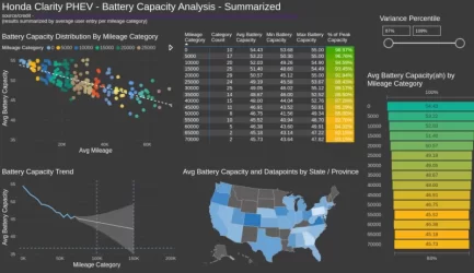

Good evening, and welcome to the forum. I took the liberty of entering your measurement into the shared spreadsheet.
We appreciate your input, and encourage you to keep track of this important parameter going forward. I do a measurement approximately every month, but that is really overkill. Maybe a few times per year is more practical.
Your reading is somewhat interesting. The average for a vehicle with ~20K miles is 50.5 Ah, but as you mention, the battery capacity is multi-faceted. Are most of your miles EV? How often do you charge, and is it Level 1 or Level 2? It's pretty hot in Texas, and maybe temperature is also a factor.

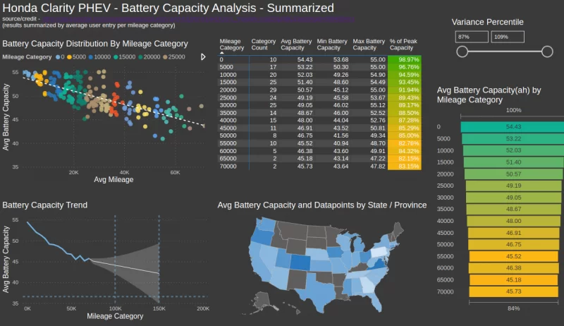

Here is the latest summarized results:

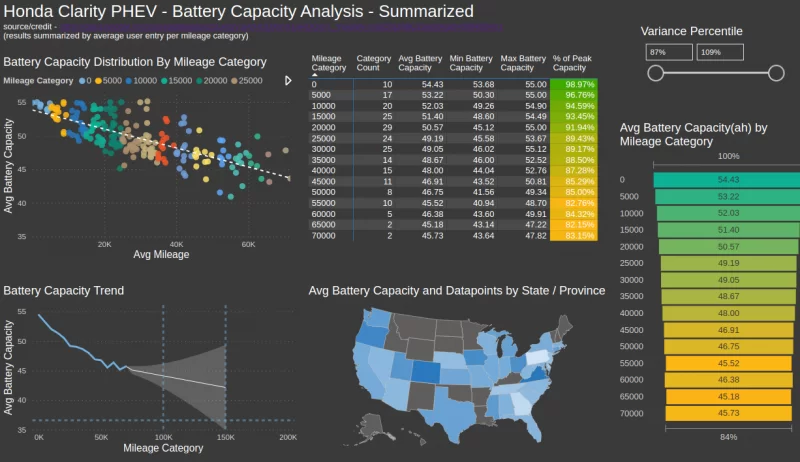

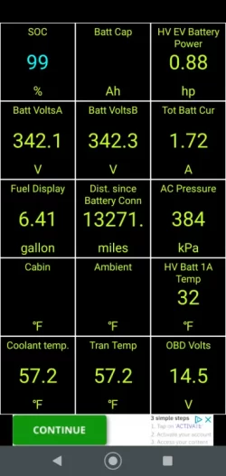

Question - I have an OBDLink LX and when it's connected it works perfectly! However, it only stays connected to my Android phone with Car Scanner for a few minutes at a time. After a few minutes in the Car Scanner dashboard view, it stops updating and if I go back one screen it shows Car Scanner as a yellow "Connecting" to the OBD device and a red "Disconnected" from the vehicle ECU - instead of green "Connected"s.
Any ideas? Not sure if this is an issue with the LX, the OBD port, or the Car Scanner app.
Greetings, and welcome to the Forum !!
  • It is very unlikely that the Clarity is at fault (I can't imagine an OBD 'failure' that would behave like this).
  • Car Scanner doesn't have this problem inherently
  • The problems we identified with adapters having insufficient buffering capacity could very well act like this (briefly working, then going belly up as it falls behind with data buffering)
  • An adapter that works 'fine' with a different vehicle means nothing. The Clarity stresses this buffering more than other vehicles...
I would therefore bet that the OBDLink LX is the culprit here. I would recommend that you purchase the known good / recommended adapter to solve this problem. ~$30 is very reasonable to get proven good performance.
