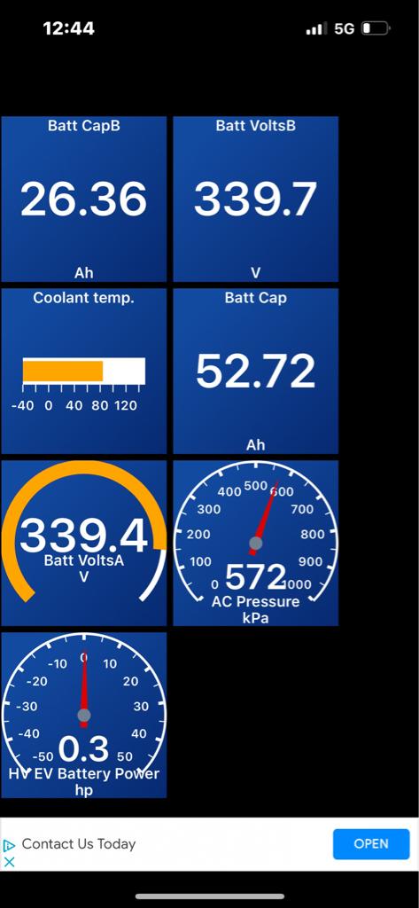

Hello All
So I took my clarity into a Honda dealer it happened to say it’s clarity certified in concord ca. I went and got an oil change and noticed a few hours after I dropped it off my guess o meter miles went to 37 to 45. But my charge percentage was the same so I knew they did not charge.
I then drove it a few days and to my surprise was getter better all Ev miles and percentage was higher after drive (same routes and temps no A/C etc. After consistently getting better miles I checked my battery capacity and it went up
I have not talk to the dealership but do they have some sort of software for the battery ? Maybe Mr Fix It would know. Thank you all for the help
I am not aware of any performance updates, software or otherwise for the Clarity,
Based on your description, I believe that your vehicle has experienced one of the mysterious battery capacity resets. There have been a handful (maybe 6) who's battery capacity readings have been reset to the original factory value of 55 Ah. It is not that the capacity actually increases, but rather, the vehicle [thinks] the capacity is higher than it really is. Over time the vehicle will re-calibrate itself and the capacity will slowly return to what it was before this happened. It seems to take a surprisingly long time, and requires not just driving miles, but many charge / discharge cycles before returning to normal. If you look at Post #409 above, you can see a plot of the members who have experienced this phenomena.
Having said that - I think you will find that you have not experienced an actual increase in your EV range, Your GOM may be indicating a higher number, but you are likely not actually achieving what the GOM is indicating. Pay close attention, not just to the charge levels and GOM, but to how many EV miles you are actually getting before the GOM gets to zero.
Your recent reading of 52.7 Ah is highly unlikely for your vehicle which has > 65K miles.
I would strongly encourage you to record the capacity on a regular basis going forward (I do it approximately once a month). If you provide your data to the shared spreadsheet, we can see if your capacity is dropping back to normal as I suspect. If you aren't familiar with the spreadsheet (or don't want to mess with it) I can enter the data for you if you report it here periodically. If you tell me your current mileage, I will enter this new data point.
I suspect that during your trip to the dealer, they did something to reset this capacity figure. We would love to know what they do, because we have seen it before. As I said, it is most likely that this is a 'false' increase, and the reported number will gradually return to normal.
