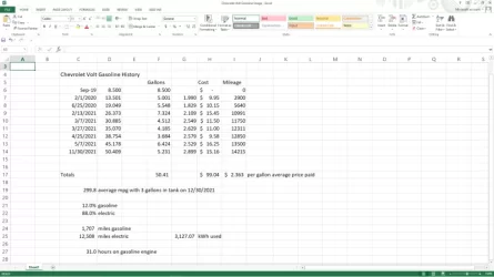

I keep an Excel spreadsheet with all the gallons of gasoline purchased and miles driven. With it, I can tell with reasonable accuracy the number of gasoline miles driven (gallons x 40), which leaves me with the number of miles on EV. Also with the estimate of number of gasoline miles driven, I can approximate the number of hours on the gasoline engine (estimated gas miles divided by average speed when burning gas). I also use this spreadsheet to estimate the kWh of electricity that the car has used. Here is a screen shot of the spreadsheet for our 2019 Chevrolet Volt:
This should give you an idea of what can be done to approximately track stuff just by keeping up with gallons of gasoline purchased.
If anyone is trying to figure out the strangeness of this history...
In Feb 2021, my wife had to start driving it to help out with her parents every week. This caused an increase in the gasoline use from highway miles on the trips. Then in late May it was in a collision which put it in the shop for nearly 6 months. There are about 3 gallons in the Volt's tank now. She started driving my Clarity in June which put more gasoline usage and highway miles it. Hooray! I have my Clarity back now!
