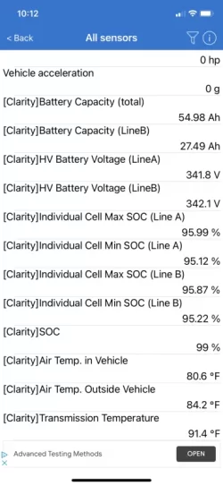

Just put mine on the scanner - seems a bit high. 2018 with 30,000 miles
Indeed...
You are not the only one who has an exceptionally high number.
We are trying to understand why there are some with very little degradation. Can you provide some details about how you operate? Are your miles mostly HV or EV? How often do you charge?
I put your basic measurement in the spreadsheet. Feel free to add some of the additional information.

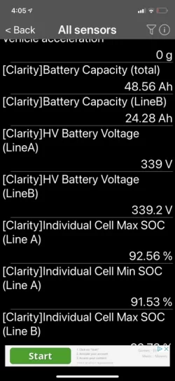

I haven't purchased it yet but I did get a handful of readings. Unfortunately my battery is only showing **48.24 Ah** max, which makes sense to why I've never seen >43 or so estimated miles if normal is 55ish.
Manufactured 7/18 I think I leased it Sept 2018 and just purchased the lease out.
