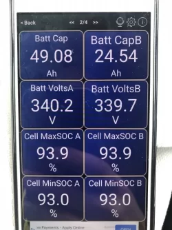

Clearly the text settings are too large on the sample dashboards.
I'm sure this is probably because I set this up on a tablet.
Can someone suggest aesthetically pleasing sizes for a phone?
I will change them and re-send a backup file.
There are three size settings for each dashboard item (title, value and units).
I had them set to 48, 100, 48. Or, if the title was too long, I lowered it some.
Is there a Auto size option in Carscanner ?
A constant size may not work with the myriad sizes of display folks have.
I don't see any kind of 'auto'.
I just looked at this on a phone and the sizes were set to 16, 48, 16.
I'll send another version of the backup file with these settings because it looks ridiculous when someone posts a screenshot.
Updated set attached... Only change is the text size on the dashboards.
The sizing on this update looks good on my Pixel 4a 5g phone, with a 6.2" screen, 1080x2340 pixels.

I made the move to the Vgate adapter. It worked fine with the Car Scanner app. I got 48.58 with 25,481 miles. Autel last reported 48.6 at 24,544 before it quit working.
  • Like
Reactions: JCA
Did another readout with improved fonts size. Last time it was 48.92, now 49.04.
much warmer temps lately might have affected the readings.
I also reduced the charger to 12A to slow down the charging, and this might have helped.
So it’s either the temp or the charging speed that has helped a bit.
i guess I will be Able to collect more data over the next year.

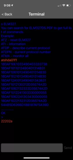

Got Car Scanner and noticed it has a profile for Clarity, so do we need to use these dashboards?
That said, I tried my cheap reader (Kobra) - it’s a wifi one cause at the time I got it, only wifi ones would work with iPhones.
Don’t get a Buffer error but also not getting all the lines. Also, not getting the battery charge either. Any ideas?
